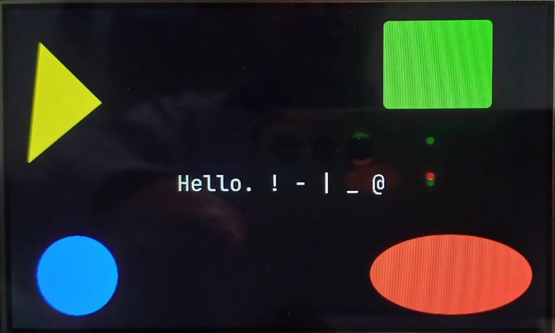

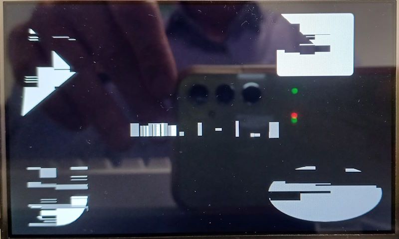

Although many things work fine with the NemaGFX and NemaVG libraries, I have a few issues.
All functions that use the NemaGFX library work fine.
Many functions that use the NemaVG library also work fine. For example arc, line and rectangle.
However, a few functions that use the NemaVG library produce distorted graphics.
Below you can see a triangle (top left), rounded rectangle (top right), text (middle), circle (bottom left) and ellipse (bottom right). The kit is a STM32U5G9J-DK2. Heap and stack space are set to 0x800, it seems that changing this makes no difference as it comes from 0x200 and 0x400.
The text in the center represents "Hello. ! - | _ @", and can be recognized somewhat by the area that lights up.
For each, I will show the code I used.
I'm sure I'm doing somthing wrong. But what is it?
It's hard to find good examples of this anyway, but I hope someone has some brilliant ideas.
Hello @Jack3 ,
This post had issue with SVG where the end result / display bug looked very similar to your issue, perhaps it could be helpful to you but I am not sure.
The fix was to add these 2 lines:
    /* Force GPU accesses to SRAM through DCACHE2 to be always uncached */
    __HAL_RCC_SYSCFG_CLK_ENABLE();
    HAL_SYSCFG_DisableSRAMCached();
to the MX_DCACHE2_Init function.
Regards,
Gaetan Godart
Software engineer at ST (TouchGFX)

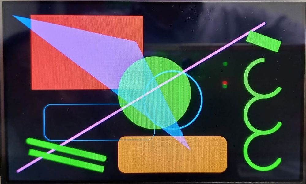

Hi Gaetan, that's the fix! Thank you very much!
BTW, in the distorted images, I used all white color for those, but coloured them this time.

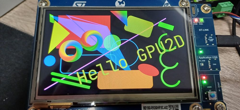

The GPU2D is impressive! Drawing the graphics below takes 16 ms only:

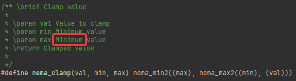

I'm not sure how to report little cosmetic code issues back, but here one that needs a correction (both in code and in documentation), though it almost is a non-issue:
The marked word "Minimum" probably should be changed into "Maximum".
I hope will be picked up by ST, if not by TS.
Hello @Jack3 ,
Thank you for the information, a TouchGFX employee is looking at it.
