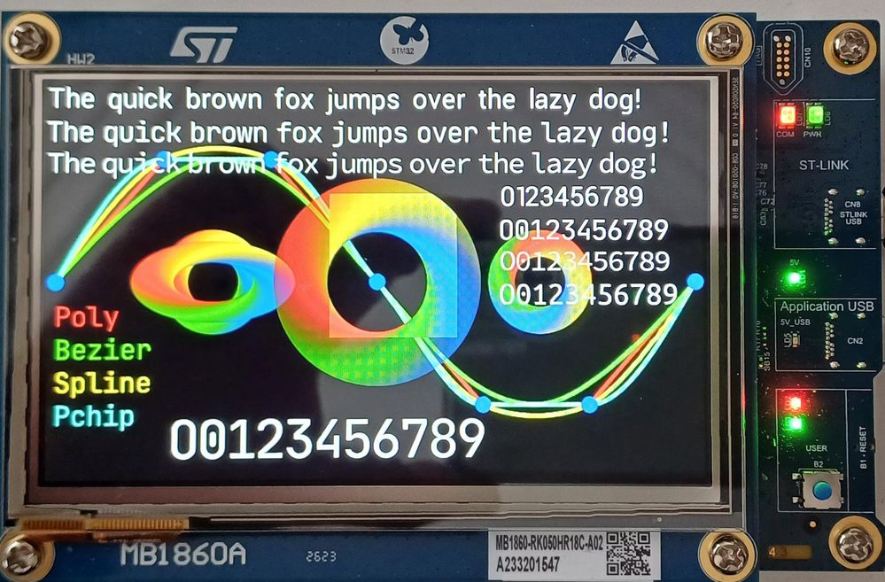

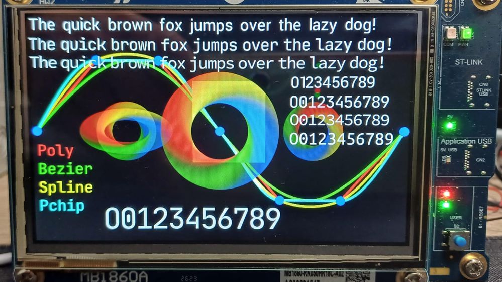

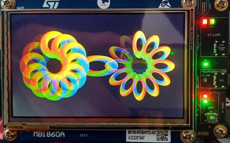

Just some demos on a STM32U5G9J-DK2 discovery kit with STM32U5G9ZJ MCU, using NemaGFX, without TouchGFX or LVGL used.

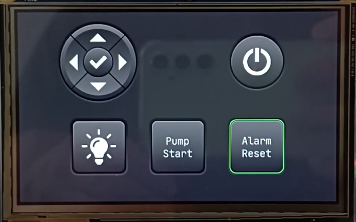

The buttons, gauge, and VU meter doesn't use any bitmaps, they are rendered by the GPU2D.
The only bitmaps in the demo are the icons. The gauge now uses such an icon in it.
The uploaded video is not as smooth and sharp as the display, somehow. There's lots of compression in it.
My phone's camera isn't very good as well.
The breakoutboard on the left is an RTC (RV-8803)
Here are the linkd to it, enjoy!

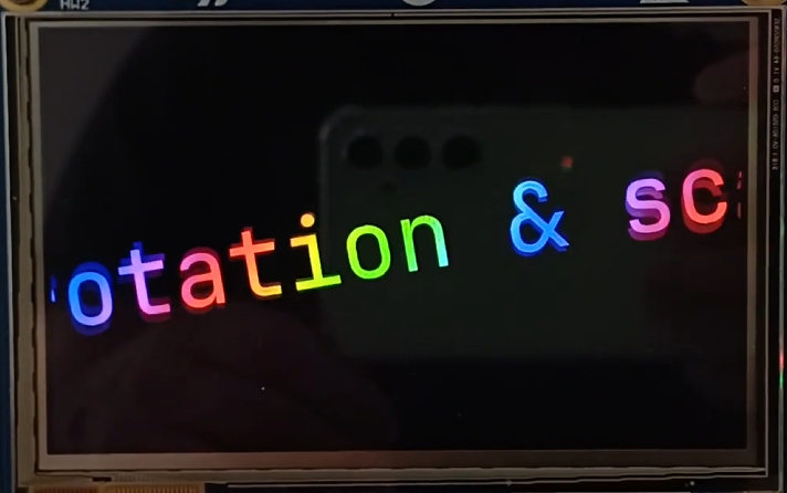

Text rotation and gradiation
No bitmaps, except the white icons:

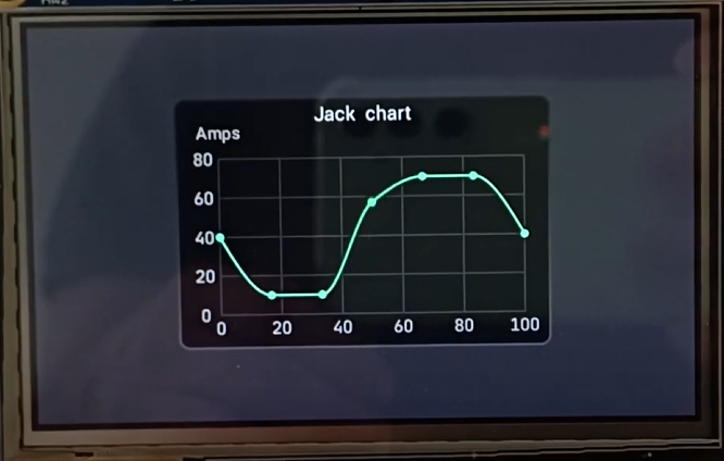

Smoothly animating graph

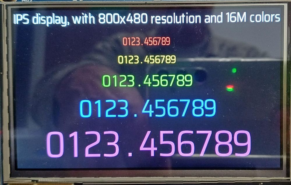

I created a per-pixel scalable font and text library. This text took 1ms to display on the screen.
The text is also 360-degree rotatable (float).

I work with the VTK toolkit, and I thought Nema could read 3D meshes, but that is not the case. In the video above, the scalable text looked to me like a 3D mesh, but it is not.
The demos above are interesting, but I later realized that similar smooth, moving 3D animations are also available in GfxDesigner demos using TouchGfx. So I do not understand why this is considered such an achievement - bypassing TouchGfx and using Nema primitives directly. Mind you, I am not undermining the demos above; I just do not have enough knowledge to appreciate why this could not be implemented in TouchGfx.
Is it the size of the code? The speed? The quality of rendering?
