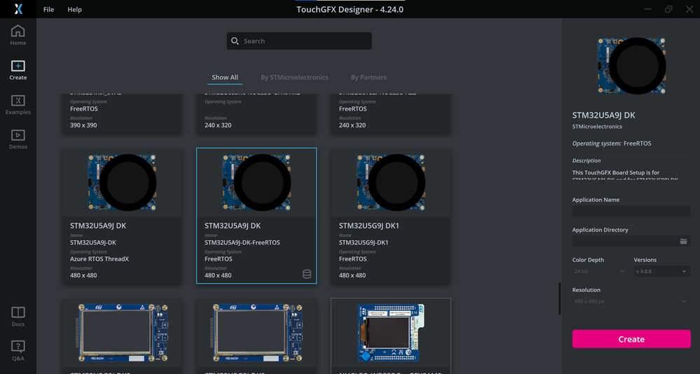

It depends on the project you are working on, if you think it benefits the performance of your application, then you can enable it. However, you don't need to enable the MPU for TouchGFX project to work on.
You can get inspiration from the STM32U5A9DK Board Setup that is available in the TouchGFX designer for configuring your board.
STM32U5A9J DK board setup

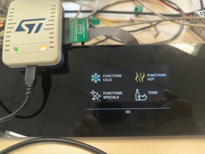

maybe I asked the question too simply
I already have a working project with several screens in a real device
I read in some application notes that the mpu is mandatory, but they talked about cortex M7 not M33
I had doubts whether it should also be activated for the M33
Thanks for you reply.
