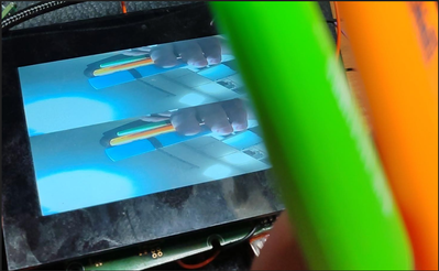

With this configuration I see double images in the screen. What could be wrong with it?

Please attach a screenshot of the screen or the display configuration. The issue is more likely related to the display rather than the DCMIPP or the sensor.

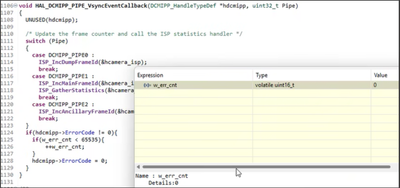

(No overrun on dcmipp or any other error ? frames received correctly ?)
Best regards.
Clyasenth
Display output looks like this.

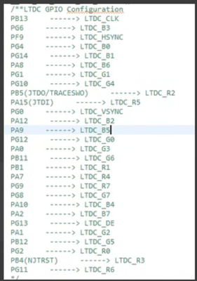

For the display side LCD 24bit RGB interface

But we initialize RGB565 to display camera output directly to the display.
LCD resolution is 800x480.
Also I added an error counter in to the code and run the code many times but there is no error received.
