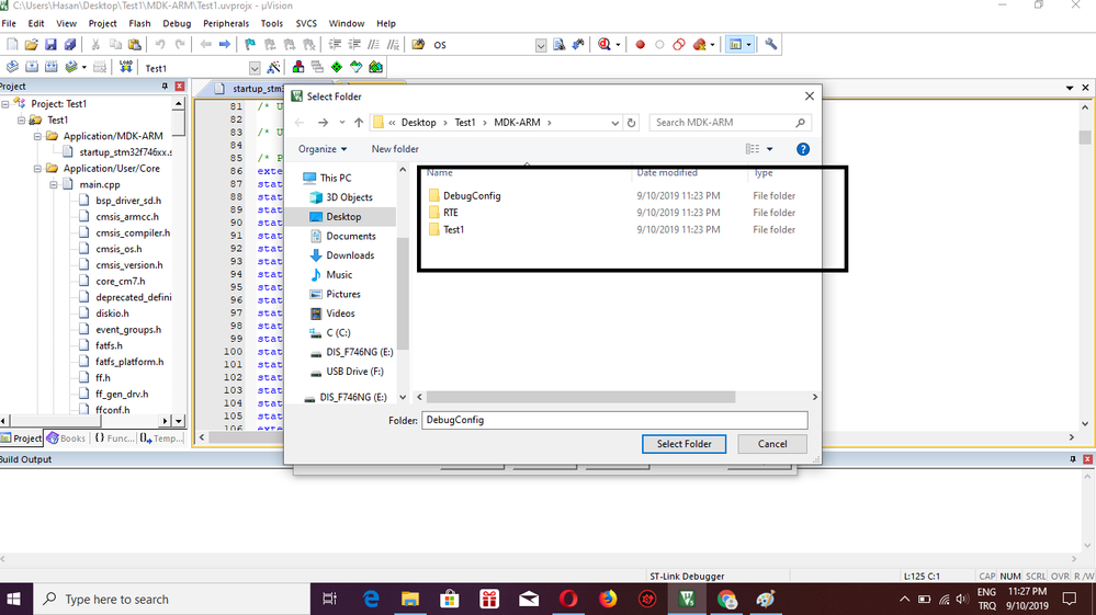

how to install touchgfx touch libraries keil
Do you have a description of this issue

For keil you simply add the library to the project like you would a source file.
/Martin
