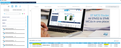

I select a new project and select the STM32L100C6U6A. STM32CubeMX says it has 4 kBytes of RAM.
I generate the project for EWARM.

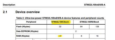

And the datasheet for STM32L100C6U6A says 4 kByte.
