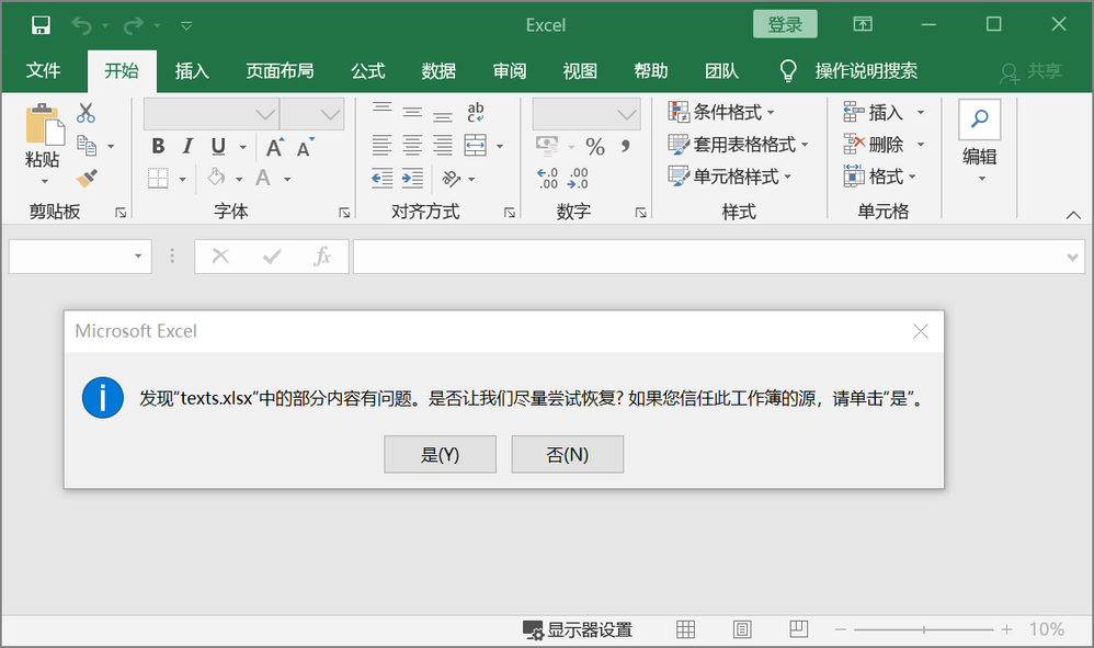

When Microsoft excel 2016 opens texts.xlsx, it will report some error. If I accept corrections and save the file, the designer can not recognize the file.
the text resource accumulates more and more, I must re-order the content. Which version or what other software should I use to modify the texts.xlsx.

Please show me a screenshot of the error. You can use any Excel version that knows the xlsx format. The hint may be in the error you're getting when opening (corrupt file, etc.)
/Martin
shark
Senior
the chinese message is: some content has problem, shall I recover it?
If I select yes, designer will failed to load it.
if I select no, ms excel will failed to open the file.
even if I open the original file from your demo example, same error message is shown.

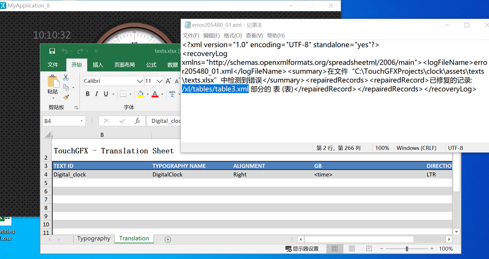

0693W000000VN8yQAG.pngevery demo are failed, this is screen shot of analog clock.
there are 3 sheets in file? I see only 2, the error message looks like "xl/tables/table3" has error and is removed

Yours has errors and needs to be recovered, excel tells me.
