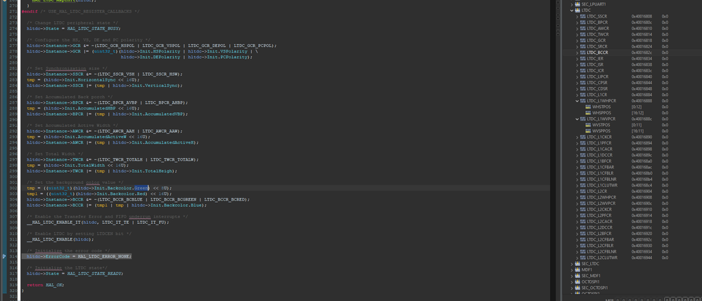

I observed the registers as i stepped through the HAL_LTDC_Init() and none of the LTDC registers are being updated, so LTDC is never setup nor enabled as they aren't being written to... what could cause this?
The init vars do have the cubemx values in them

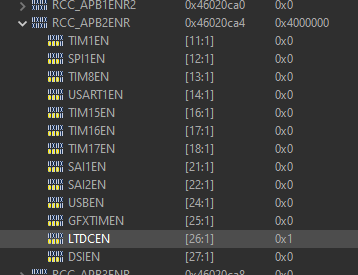

Make sure the LTDC clock is explicitly enabled in the RCC
LTDCEN in RCC_APB2ENR
Yes, this is set.
And all the registers are still stuck-at-zero?

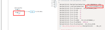

void HAL_LTDC_MspInit(LTDC_HandleTypeDef* hltdc) { GPIO_InitTypeDef GPIO_InitStruct = {0}; RCC_PeriphCLKInitTypeDef PeriphClkInit = {0}; if(hltdc->Instance==LTDC) { /* USER CODE BEGIN LTDC_MspInit 0 */ /* USER CODE END LTDC_MspInit 0 */ /** Initializes the peripherals clock */ PeriphClkInit.PeriphClockSelection = RCC_PERIPHCLK_LTDC; PeriphClkInit.LtdcClockSelection = RCC_LTDCCLKSOURCE_PLL2; PeriphClkInit.PLL2.PLL2Source = RCC_PLLSOURCE_HSE; PeriphClkInit.PLL2.PLL2M = 1; PeriphClkInit.PLL2.PLL2N = 9; PeriphClkInit.PLL2.PLL2P = 2; PeriphClkInit.PLL2.PLL2Q = 2; PeriphClkInit.PLL2.PLL2R = 6; PeriphClkInit.PLL2.PLL2RGE = RCC_PLLVCIRANGE_1; PeriphClkInit.PLL2.PLL2FRACN = 3072.0; PeriphClkInit.PLL2.PLL2ClockOut = RCC_PLL2_DIVR; if (HAL_RCCEx_PeriphCLKConfig(&PeriphClkInit) != HAL_OK) { Error_Handler(); } /* Peripheral clock enable */ __HAL_RCC_LTDC_CLK_ENABLE(); __HAL_RCC_GPIOE_CLK_ENABLE(); __HAL_RCC_GPIOF_CLK_ENABLE(); __HAL_RCC_GPIOD_CLK_ENABLE(); /**LTDC GPIO Configuration PE2 ------> LTDC_R0 PE3 ------> LTDC_R1 PE4 ------> LTDC_B0 PE5 ------> LTDC_G0 PE6 ------> LTDC_G1 PF13 ------> LTDC_B1 PE7 ------> LTDC_B6 PE8 ------> LTDC_B7 PE9 ------> LTDC_G2 PE10 ------> LTDC_G3 PE11 ------> LTDC_G4 PE12 ------> LTDC_G5 PE13 ------> LTDC_G6 PE14 ------> LTDC_G7 PE15 ------> LTDC_R2 PD8 ------> LTDC_R3 PD9 ------> LTDC_R4 PD10 ------> LTDC_R5 PD11 ------> LTDC_R6 PD12 ------> LTDC_R7 PD14 ------> LTDC_B2 PD15 ------> LTDC_B3 PD0 ------> LTDC_B4 PD1 ------> LTDC_B5 PD3 ------> LTDC_CLK PD6 ------> LTDC_DE PE0 ------> LTDC_HSYNC PE1 ------> LTDC_VSYNC */ GPIO_InitStruct.Pin = GPIO_PIN_2|GPIO_PIN_3|GPIO_PIN_4|GPIO_PIN_5 |GPIO_PIN_6|GPIO_PIN_7|GPIO_PIN_8|GPIO_PIN_9 |GPIO_PIN_10|GPIO_PIN_11|GPIO_PIN_12|GPIO_PIN_13 |GPIO_PIN_14|GPIO_PIN_15|GPIO_PIN_0|GPIO_PIN_1; GPIO_InitStruct.Mode = GPIO_MODE_AF_PP; GPIO_InitStruct.Pull = GPIO_NOPULL; GPIO_InitStruct.Speed = GPIO_SPEED_FREQ_VERY_HIGH; GPIO_InitStruct.Alternate = GPIO_AF8_LTDC; HAL_GPIO_Init(GPIOE, &GPIO_InitStruct); GPIO_InitStruct.Pin = GPIO_PIN_13; GPIO_InitStruct.Mode = GPIO_MODE_AF_PP; GPIO_InitStruct.Pull = GPIO_NOPULL; GPIO_InitStruct.Speed = GPIO_SPEED_FREQ_VERY_HIGH; GPIO_InitStruct.Alternate = GPIO_AF8_LTDC; HAL_GPIO_Init(GPIOF, &GPIO_InitStruct); GPIO_InitStruct.Pin = GPIO_PIN_8|GPIO_PIN_9|GPIO_PIN_10|GPIO_PIN_11 |GPIO_PIN_12|GPIO_PIN_14|GPIO_PIN_15|GPIO_PIN_0 |GPIO_PIN_1|GPIO_PIN_3|GPIO_PIN_6; GPIO_InitStruct.Mode = GPIO_MODE_AF_PP; GPIO_InitStruct.Pull = GPIO_NOPULL; GPIO_InitStruct.Speed = GPIO_SPEED_FREQ_VERY_HIGH; GPIO_InitStruct.Alternate = GPIO_AF8_LTDC; HAL_GPIO_Init(GPIOD, &GPIO_InitStruct); /* LTDC interrupt Init */ HAL_NVIC_SetPriority(LTDC_IRQn, 0, 0); HAL_NVIC_EnableIRQ(LTDC_IRQn); HAL_NVIC_SetPriority(LTDC_ER_IRQn, 0, 0); HAL_NVIC_EnableIRQ(LTDC_ER_IRQn); /* USER CODE BEGIN LTDC_MspInit 1 */ /* USER CODE END LTDC_MspInit 1 */ } }

I tried the following and LTDC register will not accept anything.
LTDCRST = 0
LTDCEN = 1
while (1) { /* USER CODE END WHILE */ temp = LTDC->GCR; LTDC->GCR = 1; /* USER CODE BEGIN 3 */ } /* USER CODE END 3 */ }
Could it be something with my clock setup?
I added an I2C peripherial and after MX_I2C1_Init() i can see values in the I2C registers, but nothing for LTDC...

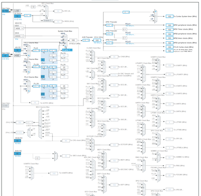

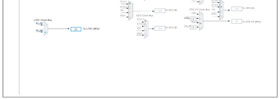

waclawek.jan
So, which one is it, PLL2 or PLL3?
Read out and check/post relevant RCC registers content.
