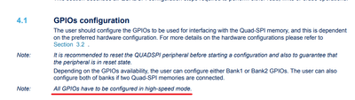

I noticed that any example created with touchGfx for the STM32H750B-DK demo board uses the ExtMem_Boot bootLoader that uses a 400Mhz clock instead of 480Mhz, but the strangest thing is that it uses a QSPI clock of only 50Mhz, when from the memory datasheet it could reach 120Mhz.

You need also to insure the GPIOs used by the QuadSPI are in high or very high speed mode:
AN4760:
