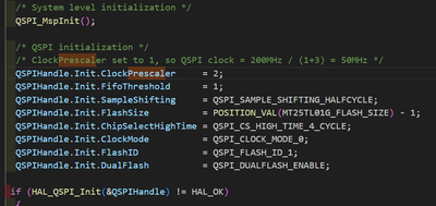

I noticed that any example created with touchGfx for the STM32H750B-DK demo board uses the ExtMem_Boot bootLoader that uses a 400Mhz clock instead of 480Mhz, but the strangest thing is that it uses a QSPI clock of only 50Mhz, when from the memory datasheet it could reach 120Mhz.
