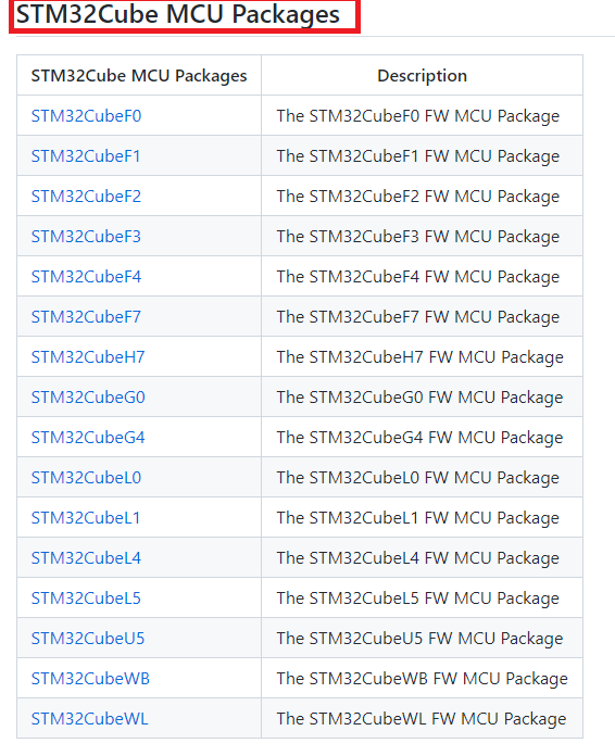

HI @WPong.1​ ,
From this page you can choose the suitable STM32Cube MCU package depending on the MCU you work with. For example, if you used the STM32F7 MCU you can click on STM32CubeF7/Projects/STM32F769I_EVAL/Examples/DCMI.
So, you can find in this link the DCMI examples with STM32F769I-EVAL board.
