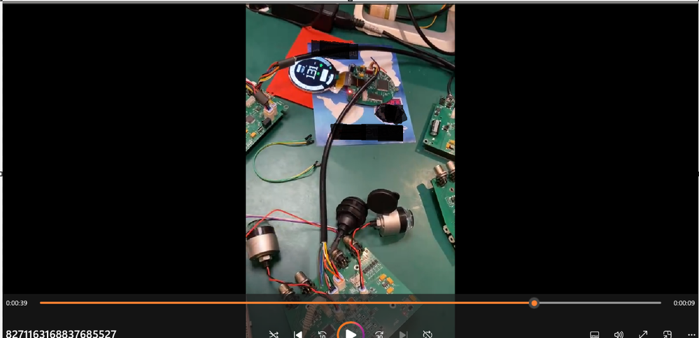

LCD shift during display
BLS_Karo

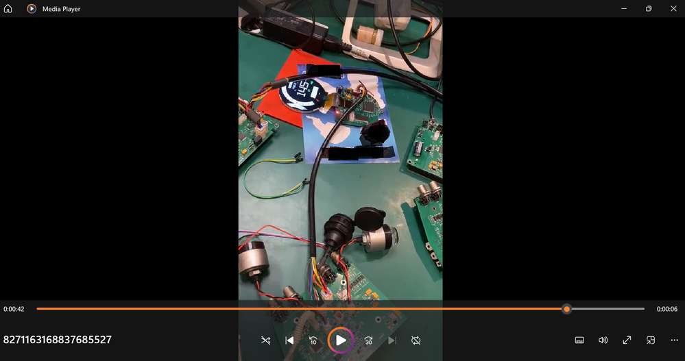

BeforeBeforeAfterAfterHello everyone.
I am in a tough situation when the LCD shift during display without touching the board as some pictures above:
I am using STM32F469ZIT6 and SDRAM IS42S16400J-6TLI. Here is the configuration:

 Refresh count equals 683 and clock for SDRAM is 90MHz

xuxu998
the display is in the middle of the image for anyone can not see it
