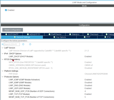

Currently I am struck with Ethernet communication where I am not able to communicate properly.
I have working functionality with static IP. I have implemented functionality to either enable DHCP or Static. Independently both works. When I am trying to call an event to enable DHCP or static my board hangs or freezes. Sometimes I jump into Hardfault_handler error.
After debugging I noticed that my memory mapping somehow I am not able to figure out the exact root cause. I am using Touchgfx as an output interface.
I followed your F7 videos and tried to fix the solution but didn't work. Maybe I thought of asking for your help. I share my linker script and MPU_config and also Ethernet descriptor.
My current script expects to keep assets text, font, extflash related to touchgfx in QSPI memory, SDRAM wants to add Touchgfx_scrollbars etc. I tried to use the QSPI location but failed. RAM memory location where I am currently facing an issue. I attached my linker script for reference.

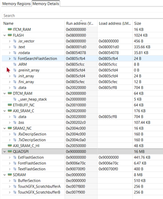

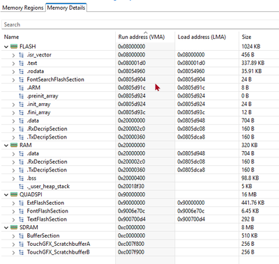

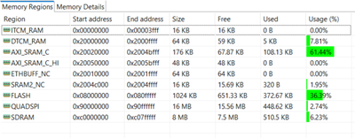

#define PBUF_POOL_BUFSIZE 1536 and my linker Script
 ** @file : STM32F746NGHX_FLASH.ld
 ** @brief : Linker script for STM32F746NGHx (1024KB FLASH, 320KB RAM)
 ** - DTCM (64KB) used for stack/heap (fast, CPU-only)
 ** - AXI SRAM cached (176KB low + optional 48KB high)
 ** - ETH descriptors in SRAM2 (16KB, non-cacheable)
 ** - ETH Rx/Tx buffers in AXI 64KB non-cacheable window
 ** - TouchGFX buffers in SDRAM, assets in QSPI
ENTRY( Reset_Handler)
/* ====== Memory map ====== */
MEMORY
	/* TCMs */
	ITCM_RAM (xrw) : ORIGIN = 0x00000000, LENGTH = 16K
	DTCM_RAM (xrw) : ORIGIN = 0x20000000, LENGTH = 64K /* stack/heap, fast */
	/* AXI SRAM (cached regions) */
	AXI_SRAM_C (xrw) : ORIGIN = 0x20020000, LENGTH = 176K /* main .data/.bss */
	AXI_SRAM_C_HI(xrw) : ORIGIN = 0x20050000, LENGTH = 48K /* optional extras */
	/* AXI SRAM non-cacheable carve-outs (must match MPU) */
	ETHBUFF_NC (xrw) : ORIGIN = 0x20010000, LENGTH = 64K /* ETH Rx/Tx buffers */
	SRAM2_NC (xrw) : ORIGIN = 0x2004C000, LENGTH = 16K /* ETH descriptors */
	/* Non-volatile / external */
	FLASH (rx) : ORIGIN = 0x08000000, LENGTH = 1024K
	QUADSPI (r ) : ORIGIN = 0x90000000, LENGTH = 16M
	SDRAM (xrw) : ORIGIN = 0xC0000000, LENGTH = 8M
/* ====== Stacks & libc heap placed in DTCM ====== */
_estack = ORIGIN(DTCM_RAM) + LENGTH(DTCM_RAM);
_Min_Heap_Size = 0x0A00; /* libc heap (if used) */
_Min_Stack_Size = 0x0A00; /* process stack reserve */
/* Used by startup to copy .data from FLASH */
_sidata = LOADADDR(.data);
/* ====== Sections ====== */

  • Call MPU_Config() before enabling caches.
  • Then SCB_EnableICache(); SCB_EnableDCache();
  • linker matches:
    • .ETH_NC_Buffers at 0x20010000 (64 KB NC)
    • .RxDecripSection/.TxDecripSection at 0x2004C000 (16 KB NC)
    • General .data/.bss in AXI cacheable (0x20020000…)
    • Stack/heap in DTCM (0x20000000…)

please could someone guide me and correct my linker script and MPU configuration. I assume the DTCM and DMA are overlapping with the RAM memory and the buffer is not able to communicate with ARP from pc.
Looking forward for your inputs. Thank you.
@stm32f746 discovery board

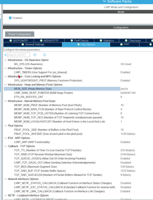

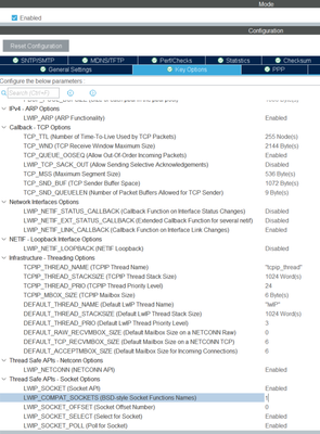

Did you check Ethernet stack size and usage ? when you enable both, you need to increase cache size.
Hi @mbarg.1
thank you so much for your response and supporting me. Yes, I have update few inputs  in "lwipopts.h" file but i am currently not sure about the configuration. It would be really appreciated if there is any standard configuration for Lwip Ethernet that works with stm32f746NGHS discovery board.  Pleae
/* USER CODE BEGIN 1 */
#define LWIP_TCP 1
#define LWIP_NETCONN 1
//#define LWIP_DHCP 1
#define LWIP_DNS 1 // handy for MQTT later
#define LWIP_NETIF_HOSTNAME 1
#define LWIP_MDNS_RESPONDER 1 // mDNS (.local)
#define LWIP_IGMP 1 // required for IPv4 multicast 224.0.0.251
#define LWIP_NETBIOSNS 1 // optional: Windows NetBIOS name
#define LWIP_NUM_NETIF_CLIENT_DATA 1 /* required by mDNS */
#define LWIP_SO_RCVTIMEO 1
#define LWIP_AUTOIP 0
#define LWIP_DHCP_AUTOIP_COOP 0
#define LWIP_MQTT 1
#define TCPIP_THREAD_STACKSIZE 3072
#define DEFAULT_THREAD_STACKSIZE 1536
#define MEM_SIZE 16*1024
#define PBUF_POOL_SIZE 16
#define LWIP_RAM_HEAP_POINTER 0x2004C140
/* USER CODE END 1 */
I am adding screenshots ioc information and manual changes in code for reference for better understanding.
I assume DMA Rx and Tx buffer and DTCM non sharable and non cacheable are causing problem.
Stm32f746 host device updated NET link up but when i tried to ping on laptop I get host unreachable. this is due to DMA bufferes are not recognized or dont have memory is not handled properly.
Any further suggestions would be really appreciated.

The below images wherer i have update my memory for DTCM, SRAM1 and SRAM2 at the end either the TougchGFX freeze or hard fault error or sometime i can't run other applicaitons
Thank you.
