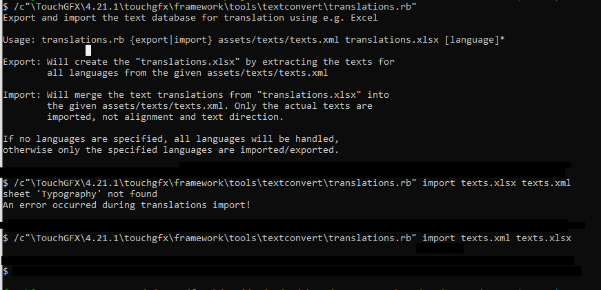

I sucessfuly exported texts.xml with translations.rb
but when I try to import .xlsx back to .xml. I get the error sheet Typography not found!?
> translations.rb import texts.xlsx texts.xml
sheet 'Typography' not found
An error occurred during translations import!
Bellow are the files used
Solved! Go to Solution.

‎2023-02-06 8:32 AM
Could not be the problem in swapped .xml and .xlsx extentions in your command ?
Here is what my system shows:
Also, my conversions run without .xsd file present.

Did you found any solution. I think I am in the corect path/folder because export works fine. Also the error sais it cannot find typography sheet not tool, or is this the same?
‎2022-12-12 6:27 AM
Found the solution.
It is necesary to copy also the texts.xsd file to the path. This was not clearly specified in the documentation.
‎2023-02-06 8:32 AM
