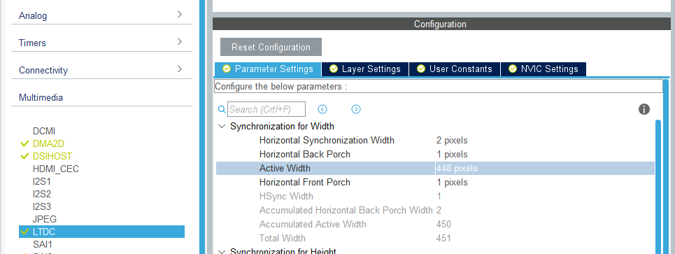

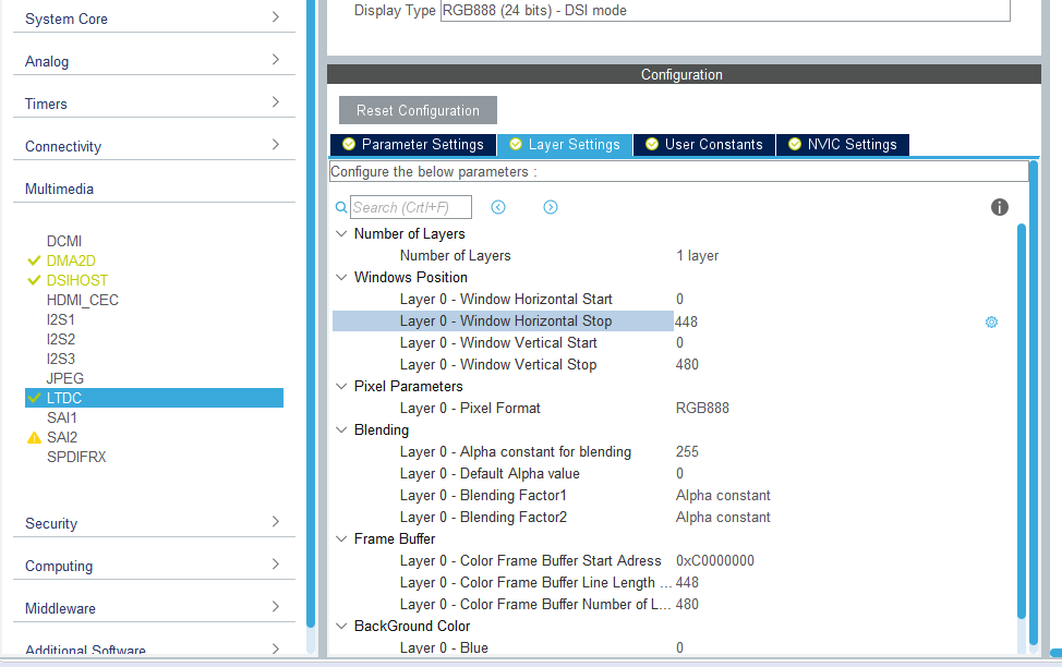

I recently tried the Application Template for the Stm32F769i-Discovery board and noticed that the horizontal sizes in the CubeMX file are 448 instead of 800:
This appears to be incorrect.
19 REPLIES 19
Martin KJELDSEN
Chief III
It's correct, but confusing - I agree =) It has to do with the "chunks" of the framebuffer we transfer to the DSI display for 16 and 24 bits respectively, to avoid tearing. And 448*2=896 also has special significance. If you check the HAL code you'll find that we split the framebuffer into these areas and transfer one at a time until done. (TE and EndOfRefresh interrupt handlers)
You can't represent this intention in CubeMX in a clear way, though :)

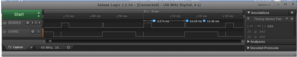

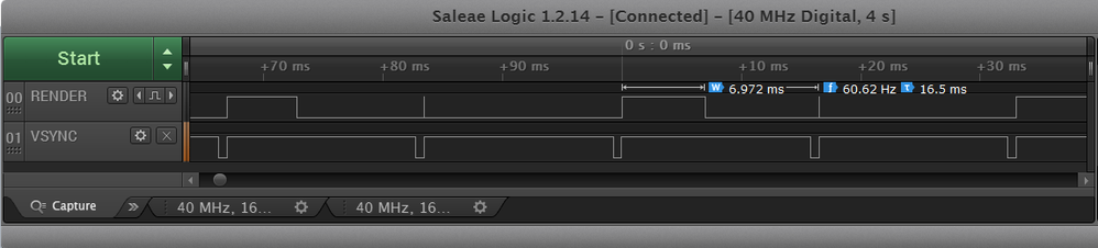

A little help would be much appreciated. I am seeing about 2 X the RENDER_TIME of the Discovery kit with the same animation being run on both.
I have looked at the TouchGFXHAL.cpp file and there are many differences between the Stm32F769i-Discovery and my project--which stands to reason because DSI is being used in the Discovery board.
I am wondering if that driver has been optimized for DSI and my driver might be missing some of this optimization? HAL_DSI_EndOfRefreshCallback(), etc.
I will also add that the VSYNC_FREQ GPIO signal is different on this DSI implementation compared to my board--Notice that it is a much wider pulse (is this also caused by the DSI implementation?).
Stm32F769i-Discovery performance
My board's performance
Overall this does not look like it will cause problems. But I am planning on adding more animations per frame, so it has me concerned and would like to have at least as good performance as the F769-discovery kit.
I should also add, that I am purposefully rendering every other frame during this example.
