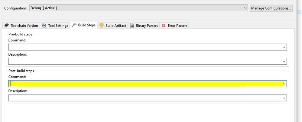

so isn't there no way to exclude QSPI update?
I want to fast the debug process: i don't want to wait 2 minutes waiting QSPI is update

Post link, can't you use objcopy --remove-section= ?

For example when you use CubeIDE in debug config turn off DOWNLOAD at all and create flash only code script without reflash QSPI.
Scritp you can place to run after build part in config.
Can you help me with this instruction?
I never use it. Have you got an example?
Must I insert the script in this section, right?

There is documentation, check what sections you have in your linker script (.LD), check those which have content via (.MAP), or dumping the .ELF file
Here with typical naming from TouchGFX, pick those contributing to your QUADSPI foot print
objcopy --remove-section=ExtFlashSection --remove-section=FontFlashSection --remove-section=TextFlashSection target.elf

The result is that objcopy --remove-section command syntax is right . is it also possibile to create a queue:
instead themost important missing code is the first part of the command:
arm-none-eabi-objcopy.exe
writing :
arm-none-eabi-objcopy.exe --remove-section=ExtFlashSection --remove-section=FontFlashSection --remove-section=TextFlashSection "${BuildArtifactFileBaseName}.elf" "${BuildArtifactFileBaseName}.elf"
 Everything works.
I checked inside the "*.elf" file the ExtFlashSection, FontFlashSection and TextFlashSection and i discovered that these sections are not even presents.
Thank you so much.
