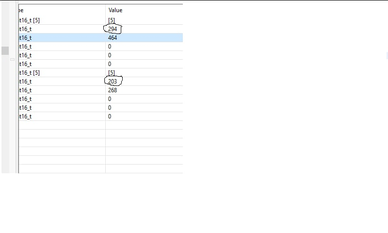

‎2022-09-20 2:13 AM
no I use touchscreen FT5316
touch is ok but the interaction not works.
why?
@Yoann KLEIN​
‎2022-09-21 1:15 AM
Then the issue comes from the driver of your touchscreen and/or the hardware configuration.
You will have to debug it or find examples/tutorials online.
A good starting point would be to put a breakpoint in your STM32TouchController::sampleTouch(int32_t& x, int32_t& y) method, to see if every time you click, this function is triggered with the right coordinates.
/Yoann
‎2022-09-21 1:21 AM
the coordination is accurate equal to button coordinates in touchgfx.
if it trig with worst coordinate why it change the button picture?
