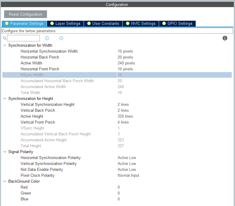

Incorrect Total Width size at LTDC / CubeMX 6.0.0 / FW_H7_V1.8.0
Panchev68
Senior
This is from CubeMX 6.0.0 / FW_H7_V1.8.0
Total Width is same as Horizontal Front Porch

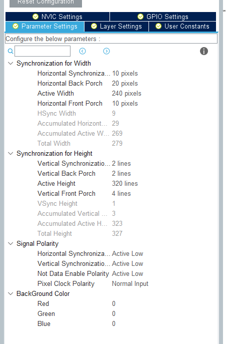

and this is for CubeMX 6.0.0 / FW_F4_V1.25.0 with the same parameters
(everything looks good here)

Amel NASRI
Hi @Panchev68​ ,
Could you please precise the selected device? You can also share your .ioc so it will be easier to reproduce issue.
I tried with STM32H743VGTx as device and settings are different for LTDC.
-Amel
