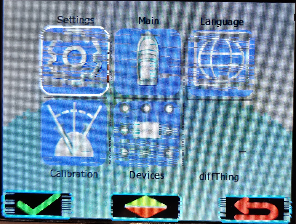

Look at the project
and look at the display
You can see artefacts.
Why?

I disabled ChromeART (DMA2D) in CubeMX options - artifacts disappeared.
Tell me, what's may be wrong with ChromeART (DMA2D) ???? How to fix?

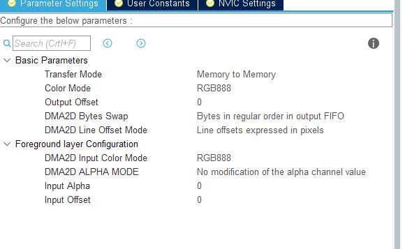

Here is my DMA2D options

I have the same problem. Moreover, once out of ten when loading these strips do not occur, and then the entire interface works normally. I use STM32F769 Disco + STM32CubeIDE + TouchGFX 4.13. At first I thought the board was defective and bought another one. The result is the same.

The DMA2D configuration will be "overwritten" by the TouchGFX HAL when doing DMA2D transfers because it knows the pixel formats of whats coming in and whats going out. I haven't seen this issue but i'll try your concrete project.

was the cause of this vertical line artifacts ever found? I am having the same issue with Hardware is similar to STM32f764-Disco, Cube IDE 1.4.2, Touch Designer 1.13.0.
