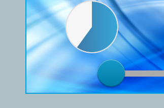

Image defect
EEuge
Senior
Look at the project
and look at the display
You can see artefacts.
Why?

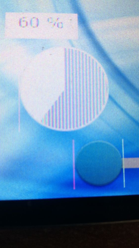

Hm.... I can delete vertical lines near pictures if I use 32-bit SDRAM as 16-bit (I reconfigured FMC). But I want to use all 32 bit. Is it bug of your library?
And stripes on circle still present, even in 16 bit mode....
EEuge
Senior
Stripes on circle disappeared, if I use RGB565...
But I want RGB888.
How?

Stm32f746be, ​MT48LC4M32B2P-6A
Project created with cumbeMX 5.5 and last version of touchgfxdesigner.
I'll upload project here later.​
EEuge
Senior
YESS!
Half of problem solved!!!!!
CubeMX hasn't automatically generated MPU_Config for SDRAM! It generated it only for qSPI (address 0x90000000)
I added this code

And stripes on circle disappears! And other widgets looks very well.
But stripes near widgets still present.
Look to the code, that i posted (MPU_Config) May be something still wrong?
