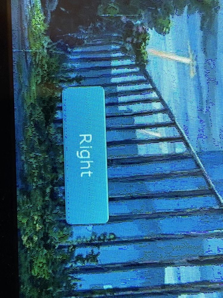

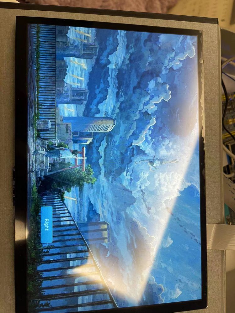

Seems you use 565 RGB and all images is convrted to this format with dithering, or you have an hw trouble...
2021-11-21 5:28 PM
Yes, the RGB565 used, but the button is generated by TouchGFX, and there is noise display separately.
2021-11-21 5:29 PM

2021-11-22 6:48 AM
Currently, it is the transparency cause, which reduces transparency can be reduced, but it is impossible to remove it. I don't know how to deal with it.
