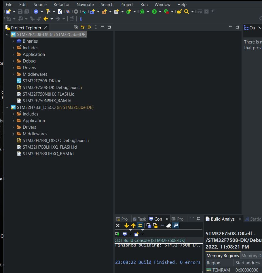

I use TouchGFX 4.19.1 Designer and STM32CubeIDE 1.9.0. The project imported in STM32CubeIDE doesn't contain the ioc file for STM32F7B3I Disco. However, for STM32F7508-DK the file is present. It's a bug?

Indeed there's a bug here, you're right. I'll get back to you when we'll have a fix for that.

Hello florinn2520,
We patched this issue. I invite you to try again, it should be working :)
Remember to delete the old STM32H7B3I-DK folder in "%AppData%\Roaming\TouchGFX-4.19.1\Downloads" so that TouchGFX Designer will take in count the patch.

It works, thank you. But every TouchGFX project is generated with the default name "STM32H7B3I-DK". If I want to generate another project and import in STM32CubeIde, a warning to replace the old project appears. Any idea to have more than a project in workspace?
This is a known issue, it's on our table. Meantime, I invite you to create a new workspace for your project, or remove your old project from your workspace.
