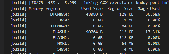

I have a custom board with STM32H7A3 using FMC, LLTC and other modules. I started to develop the firmware to change some images in a display. I made one project on TouchGFX with multiple images and fonts. I verify the BitmapDatabase.cpp and the all images files generated. For each image file generated for example:
LOCATION_PRAGMA("ExtFlashSection")
KEEP extern const unsigned char image_attention_all[] LOCATION_ATTRIBUTE("ExtFlashSection") = { // 223x265 RGB888 pixels.
    0x0b, 0xba, 0xf7, 0x0b, 0xba, 0xf7, 0x0b, 0xba, 0xf7, 0x0b, 0xba, 0xf7,
In my application.ld file I put that configurations that I view on https://support.touchgfx.com/4.18/docs/development/scenarios/using-non-memory-mapped-flash
/* Specify the memory areas */
MEMORY
DTCMRAM (xrw)      : ORIGIN = 0x20000000, LENGTH = 128K
RAM (xrw)      : ORIGIN = 0x24000000, LENGTH = 1024K
ITCMRAM (xrw)      : ORIGIN = 0x00000000, LENGTH = 64K
FLASH1 (rx)      : ORIGIN = 0x8000000, LENGTH = 512K
FLASH2 (rx)      : ORIGIN = 0x8100000, LENGTH = 512K
NOR1 (rx)      : ORIGIN = 0x60000000, LENGTH = 64M          /*External NOR Memory*/
SRAM (xrw)     : ORIGIN = 0x62000000, LENGTH = 4M          /*External SRAM Memory*/
.ARM.attributes 0 : { *(.ARM.attributes) }
	ExtFlashSection :
		*(ExtFlashSection ExtFlashSection.*)
		*(.gnu.linkonce.r.*)
        . = ALIGN(0x4);
	} >NOR1
  FontFlashSection :
		*(FontFlashSection FontFlashSection.*)
        . = ALIGN(0x4);
	} >NOR1
  TextFlashSection :
		*(TextFlashSection TextFlashSection.*)
        . = ALIGN(0x4);
	} >NOR1
When I try to build the program I have section output from compiler:
0693W00000KZdXTQA1.pngWhat I'm doing wrong?

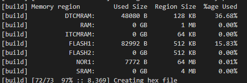

I only can write some program inside NOR1 when I change part of linker like:
 /*Original data without write anything on NOR
 /* Constant data goes into FLASH
  .rodata :
    . = ALIGN(4);
    *(.rodata)         /* .rodata sections (constants, strings, etc.)
    *(.rodata*)        /* .rodata* sections (constants, strings, etc.)
    . = ALIGN(4);
  } >FLASH1
  /* Constant data goes into FLASH */
  .rodata :
    . = ALIGN(4);
    *(.rodata)         /* .rodata sections (constants, strings, etc.) */
    *(.rodata*)        /* .rodata* sections (constants, strings, etc.) */
    . = ALIGN(4);
  } >NOR1
0693W00000KZddqQAD.pngWhat am I doing wrong? How can I have a sure that I write all images files in External Flash?

Your one image have around 170kB and isnt on any area linked, then error is in your makefile.

Are youy sure, that build is over images cpp files ?
And i see one problem
64M ends override SRAM section +32M

This morning I verify that SRAM need to be ORIGIN=0x64000000.
I think that I have the correct setting to build the project. I use Visual Studio Code with arm-none-eabi-gcc MakeFile . I add all images files (.cpp) generated by TouchGFX to my CmakeList.
What do you mean build is over images cpp files? Sorry because I never worked before with this type of architecture, I only worked before with microcontrollers PIC32.
Best regards, Luis

I tried before with BitmapDatabase.cpp and the size of program don't change. Thanks for your help, I try to search more about it.
Thanks MM1, I solved my problem looking to the problem with other ideas.
The problem that I don't have any compiler to build .cpp files.
set(CMAKE_C_COMPILER "arm-none-eabi-gcc.exe")
set(CMAKE_CXX_COMPILER "arm-none-eabi-g++.exe")
Thanks a lot for your help :grinning_face:
