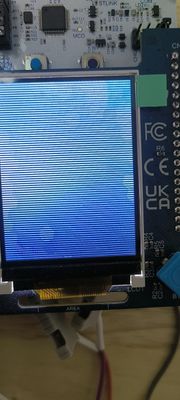

How to translate ILI9341 driver in touchgfx project to HAL version?
Zhuangwei
TFT-LCD driver:

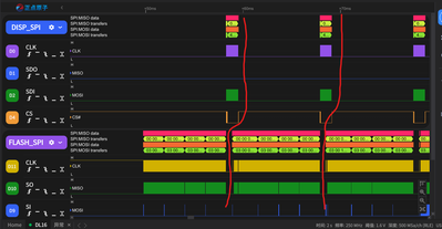

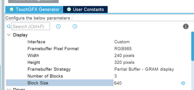

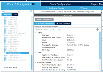

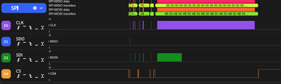

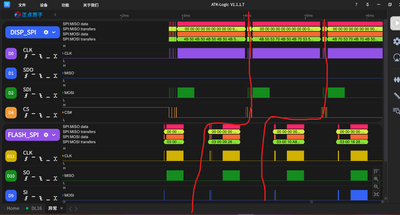

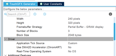

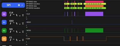

I code as above,but the screen displays black line:
I'm not sure whether my
static void send_data(uint16_t * data, uint16_t size)
    hspi1.Init.DataSize = SPI_DATASIZE_16BIT;
    if (HAL_SPI_Init(&hspi1) != HAL_OK)
        Error_Handler();
    HAL_GPIO_WritePin(DISP_CS_GPIO_Port, DISP_CS_Pin, GPIO_PIN_RESET);
    HAL_GPIO_WritePin(DISP_DCX_GPIO_Port, DISP_DCX_Pin, GPIO_PIN_SET);
    HAL_SPI_Transmit_DMA(&hspi1, (const uint8_t *)data, size);
void HAL_SPI_TxCpltCallback(SPI_HandleTypeDef *hspi)
    if (hspi == &hspi1)
        IsTransmittingBlock_ = 0;
        HAL_GPIO_WritePin(DISP_CS_GPIO_Port, DISP_CS_Pin, GPIO_PIN_SET);
        hspi1.Init.DataSize = SPI_DATASIZE_8BIT;
            Error_Handler();
        DisplayDriver_TransferCompleteCallback();
and
void DataReader_StartDMAReadData(uint32_t address24, uint8_t* buffer, uint32_t length)
    uint8_t cmd[4];
    cmd[0] = CMD_READ;
    cmd[1] = (address24 >> 16) & 0xFF;
    cmd[2] = (address24 >> 8) & 0xFF;
    cmd[3] = address24 & 0xFF;
    HAL_GPIO_WritePin(FLASH_CS_GPIO_Port, FLASH_CS_Pin, GPIO_PIN_RESET);
    HAL_SPI_Transmit(&hspi2, cmd, 4, HAL_MAX_DELAY);
    HAL_SPI_Receive_DMA(&hspi2, buffer, length);
void HAL_SPI_RxCpltCallback(SPI_HandleTypeDef *hspi)
    if (hspi == &hspi2)
        isReceivingData = 0;
        HAL_GPIO_WritePin(FLASH_CS_GPIO_Port, FLASH_CS_Pin, GPIO_PIN_SET);
are  correct or not.
My board: NUCLEO-U083RC + X-NUCLEO-GFX01M2

void HAL_GPIO_EXTI_Rising_Callback(uint16_t GPIO_Pin)
  UNUSED(GPIO_Pin);
  if (GPIO_Pin == DISPLAY_TEARING_EFFECT_Pin)
    // The draw speed of displays varies based on factors such as design, production variance, temperature and so on
    // to achieve good performance on all displays the timer tick rate needs to be adjusted based on the actual draw time of the latest frame
    // The following code dynamically adjusts the prescaler on every new frame to match the draw rate
    const uint32_t TARGET = DCS_DISPLAY_HEIGHT;         // Number of lines in display drawing direction
    volatile uint32_t count = __HAL_TIM_GET_COUNTER(&htim6);
    if(count < TARGET - 1 || count > TARGET + 1)
      const uint16_t oldPrescaler = htim6.Instance->PSC;
      const uint16_t newPrescaler = (count * oldPrescaler + TARGET / 2) / TARGET;
      // Check if the proposed new prescaler is in a reasonable range
      if (newPrescaler > 1000 && newPrescaler < 5000)
        htim6.Instance->PSC = newPrescaler;
        htim6.Instance->EGR = TIM_EGR_UG; // Reinitialize the counter and generates an update of the registers
    (&htim6)->Instance->CR1 &= ~(TIM_CR1_CEN);
    (&htim6)->Instance->CNT = 0;
    tearingEffectCount++;
    // VSync has occurred, increment TouchGFX engine vsync counter
    touchgfxSignalVSync();
    setVSYNC();
void HAL_GPIO_EXTI_Falling_Callback(uint16_t GPIO_Pin)
  UNUSED(GPIO_Pin);
  (&htim6)->Instance->CR1 = (TIM_CR1_CEN);
  clearVSYNC();
void DisplayDriver_DisplayInit(void)
  uint8_t arguments[4];
  __HAL_SPI_ENABLE(&hspi1);
  // Sleep out
  Display_DCS_Send(DCS_EXIT_SLEEP_MODE);
  HAL_Delay(100);
  // Display Normal mode
  Display_DCS_Send(DCS_ENTER_NORMAL_MODE);
  HAL_Delay(100);
  // The GFX01M2-AZ2 display (Driver IC ILI9341) needs to have the colors and X-axis inverted
  const uint8_t id = Display_DCS_Read(0xDC); // Read RDID3
  if (id == 0x00) // RDID3 for the GFX01M2-AZ2 is 0x00
    // MADCTL: Exchange RGB / BGR + Mirror X
    arguments[0] = 0x48;
    Display_DCS_Send_With_Data(DCS_SET_ADDRESS_MODE, arguments, 1);
    HAL_Delay(100);
    // Set frame rate of AZ2 to 60 fps
    arguments[0] = 0x00;
    arguments[1] = 0x1F;
    Display_DCS_Send_With_Data(DCS_FRMCTR1, arguments, 2);
    HAL_Delay(100);
  // Pixel Format
  arguments[0] = 0x05; // RGB565
  Display_DCS_Send_With_Data(DCS_SET_PIXEL_FORMAT, arguments, 1);
  HAL_Delay(100);
  // Tearing effect line on
  arguments[0] = 0; //0x00;
  Display_DCS_Send_With_Data(DCS_SET_TEAR_ON, arguments, 1);
  HAL_Delay(100);
  // Tearing effect scan line
  arguments[0] = 0;
  arguments[1] = 0;
  Display_DCS_Send_With_Data(DCS_SET_TEAR_SCANLINE, arguments, 2);
  HAL_Delay(100);
void DisplayDriver_DisplayReset(void)
  HAL_GPIO_WritePin(DISPLAY_RESET_GPIO_Port, DISPLAY_RESET_Pin, GPIO_PIN_RESET);
  HAL_Delay(100);
  HAL_GPIO_WritePin(DISPLAY_RESET_GPIO_Port, DISPLAY_RESET_Pin, GPIO_PIN_SET);
  HAL_Delay(100);
void DisplayDriver_Init(void)
  /* DMA interrupt init */
  /* DMA1_Channel1_IRQn interrupt configuration */
  HAL_NVIC_SetPriority(DMA1_Channel1_IRQn, 0, 0);
  HAL_NVIC_EnableIRQ(DMA1_Channel1_IRQn);
int touchgfxDisplayDriverTransmitActive(void)
  return IsTransmittingBlock_;
void touchgfxDisplayDriverTransmitBlock(const uint8_t* pixels, uint16_t x, uint16_t y, uint16_t w, uint16_t h)
  Display_Bitmap((uint16_t*)pixels, x, y, w, h);
void DisplayDriver_DMACallback(void)
  /* Transfer Complete Interrupt management ***********************************/
  if ((0U != (DMA1->ISR & (DMA_FLAG_TC1))) && (0U != (hdma_spi1_tx.Instance->CCR & DMA_IT_TC)))
    /* Disable the transfer complete and error interrupt */
    __HAL_DMA_DISABLE_IT(&hdma_spi1_tx, DMA_IT_TE | DMA_IT_TC);
    /* Clear the transfer complete flag */
    __HAL_DMA_CLEAR_FLAG(&hdma_spi1_tx, DMA_FLAG_TC1);
    // Wait until the bus is not busy before changing configuration
    // SPI is busy in communication or Tx buffer is not empty
    while(((hspi1.Instance->SR) & SPI_FLAG_BSY) != RESET)
    // Set the nCS
    DISPLAY_CSX_GPIO_Port->BSRR = DISPLAY_CSX_Pin;
    // Go back to 8-bit mode
    hspi1.Instance->CR2 = SPI_DATASIZE_8BIT;
    // Signal Transfer Complete to TouchGFX
    /* Transfer Error Interrupt management **************************************/
  else if ((0U != (DMA1->ISR & (DMA_FLAG_TC1))) && (0U != (hdma_spi1_tx.Instance->CCR & DMA_IT_TE)))
    /* When a DMA transfer error occurs */
    /* A hardware clear of its EN bits is performed */
    /* Disable ALL DMA IT */
    __HAL_DMA_DISABLE_IT(&hdma_spi1_tx, (DMA_IT_TC | DMA_IT_HT | DMA_IT_TE));
    /* Clear all flags */
    __HAL_DMA_CLEAR_FLAG(&hdma_spi1_tx, DMA_FLAG_GI1 );
    assert(0);  // Halting program - Transfer Error Interrupt received.
int touchgfxDisplayDriverShouldTransferBlock(uint16_t bottom)
  // Only allow block transfer if the display has drawn past the bottom of the requested block (plus a margin of two lines)
  // A timer is used to estimate how many lines have been drawn by setting the prescaler so the tick rate matches the line draw rate
  uint16_t lastLineDrawn = htim6.Instance->CNT;
  return bottom + 2 < lastLineDrawn || tearingEffectCount > 0;

Zhuangwei
extern SPI_HandleTypeDef hspi2;
volatile uint8_t isReceivingData = 0;
void DataReader_WaitForReceiveDone(void)
    while(isReceivingData)
void DataReader_ReadData(uint32_t address24, uint8_t* buffer, uint32_t length)
    uint8_t cmd[4];
    cmd[0] = CMD_READ;
    HAL_SPI_Receive(&hspi2, buffer, length, HAL_MAX_DELAY);
    isReceivingData = 1;
    //Blocked receiving version
    //isReceivingData = 1;
    uint8_t cmd[4];
    cmd[0] = CMD_READ;
    //HAL_SPI_Receive(&hspi2, buffer, length, HAL_MAX_DELAY);
    //HAL_GPIO_WritePin(FLASH_CS_GPIO_Port, FLASH_CS_Pin, GPIO_PIN_SET);
    //isReceivingData = 0;
    if (hspi == &hspi2)
I found the reason. I was too careless. My SPI FLASH driver DMA receiving code does not set the receiving flag isReceivingData. In this way, every call to DataReader_WaitForReceiveDone after receiving flash data once through DataReader_StartDMAReadData will return immediately. The following is the correct code:

Thank you for your reply.
The first two codes are my hal version code.
When I adjusted the Block Size from 2048 to 640, the black stripes disappeared.
And the waveform is as follows:
When I adjusted the Block Size from 640 to 2048, the black stripes appeared.
This is the transmission waveform after this function call.
MOSI data disappears in the second half of CLK line, but the clock is still running. I suspect there is something wrong with my dma transmission code.
Is there a sample project related to HAL version? I think I can learn from it.
The first picture is problematic and the second picture is normal.
I changed the SPI FLASH driver function DataReader_StartDMAReadData to the blocking receiving version, and everything is normal. The code is as follows:

But I don't understand why there is a problem with my DMA receiving version.
When I use DMA receiving mode, I can see from the waveform diagram that I will only read from FLASH once, that is, one line of pixel data. But normally it should be read four times, that is, four rows of pixel data. So when I use DMA to receive the version, the MOSI of DISP_SPI will be 0 after sending one line of pixel data, which is why the MOSI on the waveform chart remains zero in the second half, which is why the black line appears.The code of DMA receiving version and my TouchGFX configuration are as follows.
