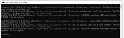

However, I didn't find the ELF file in the path TouchGFX/build/bin/target.elf; And the MDK IDE can't generate the ELF(replaced by AXF file);
When I try to use the AXF file, the command above is returned error(I also try to rename the AXF to ELF):
How to split the AXF? Or is there some tools can split the hex file by address?
