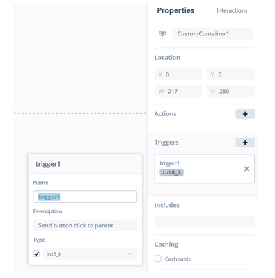

Multiple Custom Container with FlexButton Callbacks
I have been struggling to get my head around the way custom container call backs work.
I have a custom container that has three flex buttons, this container is then used on a single screenview multiple times.
I'd like to be able to identify the flex button pushed along with knowing what custom container this came from. Sounded simple and i am sure it is, my head is just failing to get around the multiple files that this process spreads across.
justin11
justin11Best answer
Senior
May 22, 2024 6:02 PM UTC
Great thanks, ill give the 2nd one a go :thumbs_up:
5 replies
Graduate II
May 22, 2024 4:29 PM UTC
Hello Justin
Easiest way (?) to make this is use Triggers in custom container and actions in view. Then you dont have to play manually with callbacks.

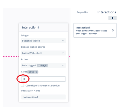

First create trigger to your CustomContainer:
The variable is used for sending the clicked button index.
And then add interaction like this to all three button:
Set value for example 0 - 2 (red circle) for buttons as index.

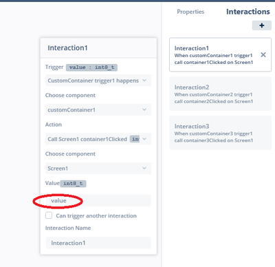

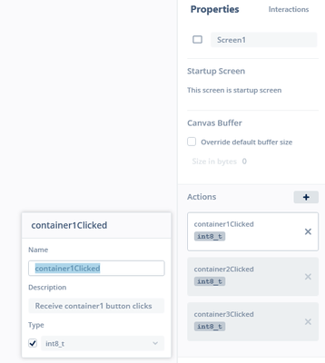

Then in the view, add three action for receiving the callbacks.
Then add three interactions like this
Remember to write red circled 'value' !
Then implement container1/2/3Clicked functions for actions, you can copy prototypes from viewBase.hpp file (if you generate the code after adding actions).
Like this in view.cpp

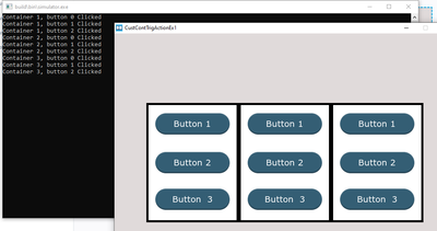

Then it works like this
But certainly this is bit sissy way, It certainly can be done also manually with callbacks. Which method you are considering ?

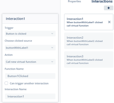

Or like this...manually:
Just set the button interactions to call virtual functions Button1/2/3Clicked at customContainer.

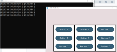

void Screen1View::CustomContainerClicked(CustomContainer& item,uint16_t buttonIndex)
	uint8_t containerIndex=0;
	if(&item==&customContainer1)containerIndex=1;
	else if(&item==&customContainer2)containerIndex=2;
	else if(&item==&customContainer3)containerIndex=3;
	touchgfx_printf("Callback received container %d! ButtonIndex: %d\n" ,containerIndex,buttonIndex);

Does pretty much the same...:
