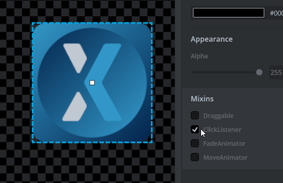

I have placed several Image widgets in my Swipe Container, now I want the image widget to support clicks and call my function, how can I make it?
I have tried to inherit from the Image widget and implement handleClickEvent, however it doesn't implement the click event that I want.
My code:

GaetanGodart
Hello @LXGMAX ,
Have a look at this video : https://www.youtube.com/watch?v=ldYSmHRLPEM&list=PLnMKNibPkDnF9x-s1e-v9Wtvv-fB88VWA&index=3
Basically, you can just check the "clickListener" at the bottom of the properties of the image:
Regards,
Gaetan Godart
Software engineer at ST (TouchGFX)

MM..1
Chief III
Activate clickable on images, and create func in screen
void Screen4View::handleClickEvent(const ClickEvent& evt)
 if(evt.getType()==ClickEvent::PRESSED && image.getAbsoluteRect().intersect(evt.getX(), evt.getY()))
