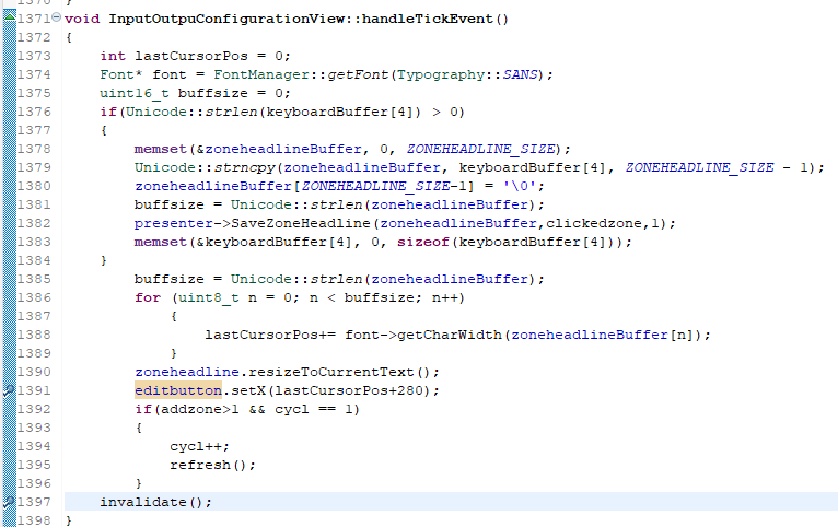

Hi @Osman SOYKURT​ ,
I've tried to debug and find out that it crashes at invalidate(); function. Invalidate function is in handleTickEvent() and it calls every tick and at third tick it crashes.
