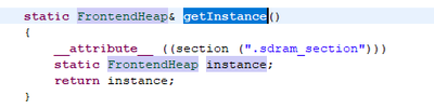

I want to store this to external SDRAM. Is it possible?
0693W00000WLbw2QAD.pngAnd I put this code to STM32H743ZITX_FLASH.Id

FrontEndHeapExtRAMSection ():
    *(FrontEndHeap FrontEndHeap.*)
    *(.gnu.linkonce.r.*)
    . = ALIGN(0x4);
  } >SDRAM
But still Frontend Heap is in internal RAM:

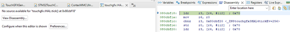

UPDATE:
It crashes at this function :
0693W00000aHBu8QAG.pngAfter this functions goes here:
0693W00000aHBumQAG.pngAnd crashes
It crashes here :
