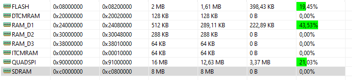

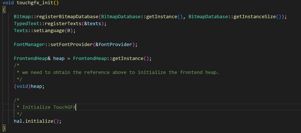

I want to store this to external SDRAM. Is it possible?
0693W00000WLbw2QAD.pngAnd I put this code to STM32H743ZITX_FLASH.Id

FrontEndHeapExtRAMSection ():
    *(FrontEndHeap FrontEndHeap.*)
    *(.gnu.linkonce.r.*)
    . = ALIGN(0x4);
  } >SDRAM
But still Frontend Heap is in internal RAM:

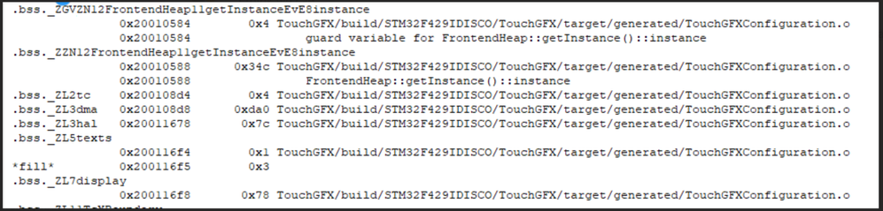

That should be doable. In the linker script you need to say that data from FrontendHeap should go to SDRAM, like you did. But as FrontendHeap is allocated by TouchGFXConfiguration.cpp, here :
0693W00000Y7INNQA3.png you need to allocate all data from TouchGFXConfiguration.o to SDRAM:
Hope that it helps,
/Yoann

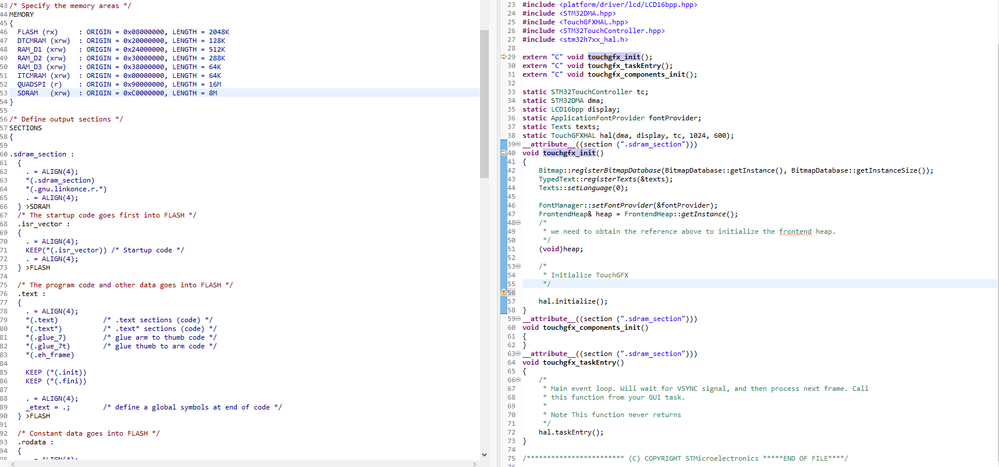

@Yoann KLEIN​ I'm trying to do like this but it's not working :0693W00000Y7MDMQA3.png

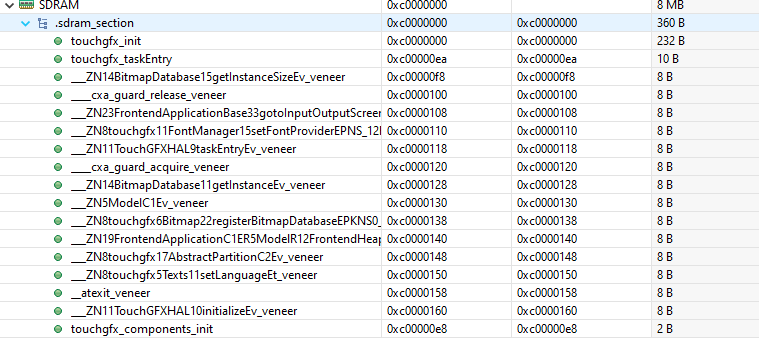

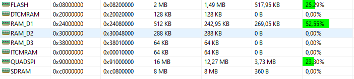

I've tried like that, but also does not work :
0693W00000Y8O9TQAV.pngit allocates only 360B:0693W00000Y8O9dQAF.png0693W00000Y8O8TQAV.png

Hello heyo,

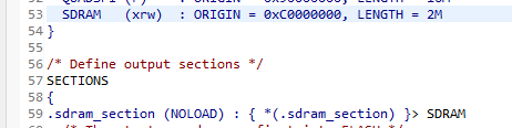

Yes it's possible to move FrontendHeap to SDRAM :
In your FrontendHeap.hpp file, declare a new section to use it in the linker script like this :
static FrontendHeap& getInstance()
        __attribute__ ((section (".sdram_section")))    // <--- add this line
        static FrontendHeap instance;
        return instance;
Then in the linkerscript, use it like this :
.sdram_section (NOLOAD) : { *(.sdram_section) }> SDRAM
Note : It will fail if the memory section allocated for it is already used (for the framebuffers storage in SDRAM for example). So to make sure, replace your framebuffer to an other address range in the TouchGFXHAL.cpp file. This is not needed if there's nothing else in SDRAM, only if you allocated your framebuffer.
void TouchGFXHAL::initialize()
    TouchGFXGeneratedHAL::initialize();
    setFrameBufferStartAddresses((void*)0xD0030000, (void*)0xD00C6000, (void*)0xD015C000);
Can you try it and tell me if that works on your side as well ?

@Osman SOYKURT​ It does not start, when I upload code It starts and immediately goes to hardfault and reset(because I add watchdog there).
I change framebuffer range :
Hardfault at this point:
