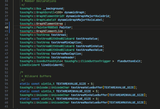

1. When using Dynamic Graph every time the code is generated the Base class is broken. This effect was also observed in previous versions.
 If the Line / Array sequence is changed and restored again and the code is generated again then all is well.

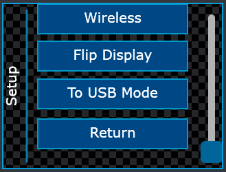

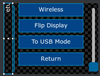

 2. On Touchgfx 4.22 I have problem with vertical text
 version 4.21.4
version 4.22
Greetings Boyan Panchev

1) I cannot reproduce this problem with code generation, could you please share your project here ?
2) That's indeed something we need to investigate, I reported it.
Thanks for your inputs on the new version :)
