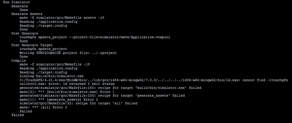

Are you sure , that lib file exist in "C:\Users\martynasveit\Desktop\C7_2(20230226)\C7_SVN\Middlewares\ST\touchgfx\lib\core\cortex_m7\gcc"
I upload files to SVN server and download from it
I upload file in directory and get no error but now I can't run simulator:
JTP1
Lead
Is the folder "C:\Users\martynasveit\Desktop\C7_2(20230226)\C7_SVN\Middlewares\ST\touchgfx\lib\win\mingw32" also empty, there should be file "libtouchgfx.a" ?
