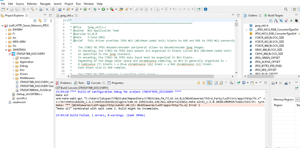

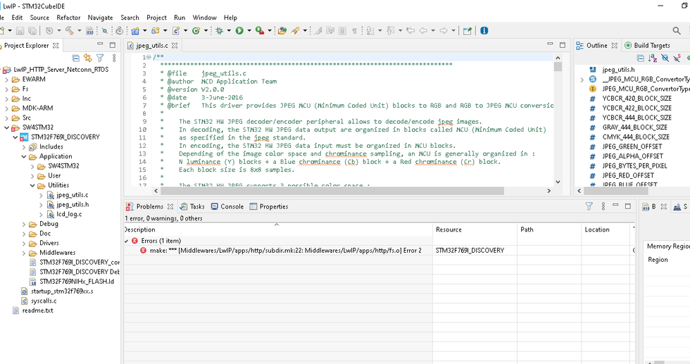

Good afternoon. I made a working project on CubeIDE for a railway timetable (LWIP, FreeRTOS, DSI, HDMI). The project was created in the repository. But the management has a requirement to add a symbolic part (JPG or bmp image). There was a problem when docking the JPEG part to the project (Error 2). How do I remove the problem? With respect. Alexander

Switch to the Console tab to find out more information about the error.

Good afternoon, Houda I found a problem in LWIP. Cubeide searches for lwip/apps/fs.h". There is no such file in the apps directory. But when compiling, CubeIDE finds it. But if the project is in the repository. If the project is rendered as an example of this file, CubeIDE does not find it. He's not there. :grinning_face: With respect, Alexander. пн, 31 ма�? 2021 г. в 13:53, ST Community :

Good afternoon, Houda. The problem occurs when attaching a jpg part to the project. This situation can be replicated with CubeMX. If you add a JPEG part to the FreeRTOS and LWIP project(http available!!!), respectfully. Alexander.
Have you tried doing a 'Clean' first before 'Build' ?
Please copy & paste the Console output as text - so we can see it all
