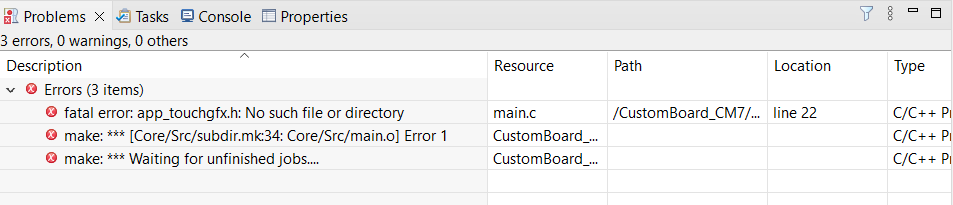

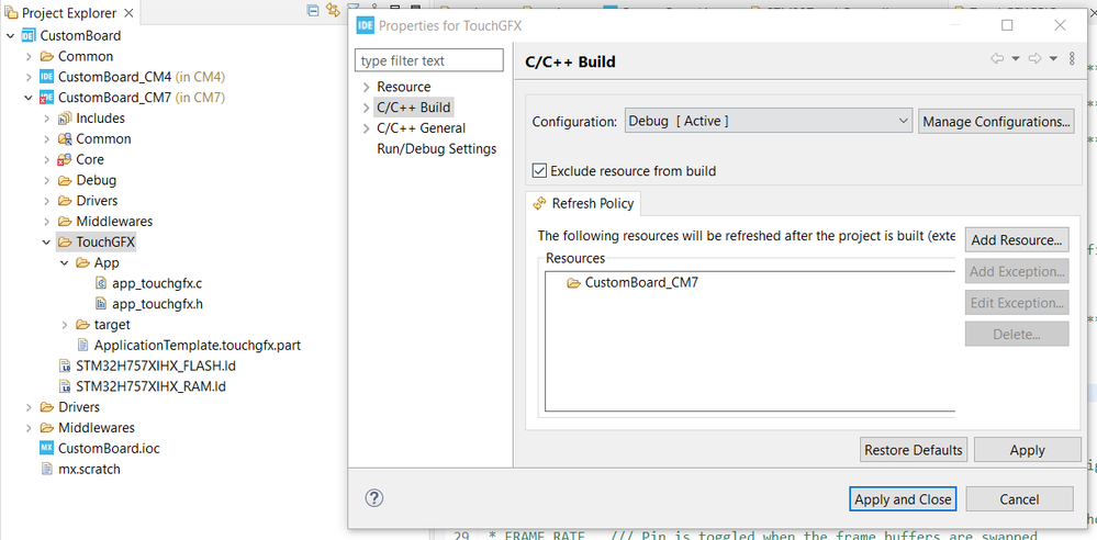

Hello Everybody, I am trying to create a TouchGFX project for my custom board. I follow embryonic.dk's video on Youtube. However I couldn't manage to build a project. I received errors in the first image. It says No such file or directory for app_touchgfx.h. However, It is in the project. The interesting thing is when I check it's properties the exclude resource from build option was selected.I deselect it. But I receive more errors. I tried to deselect exclude from build option for every folder in the project manually but it didn't work. How can I create a TouchGFX project for my custom board? I was not expecting that it's gonna be that hard. I don't have much knowledge. I am using STMCubeIDE version 1.10.1, TouchGFX generator version 4.20 and TouchGFX Designer version 4.20.

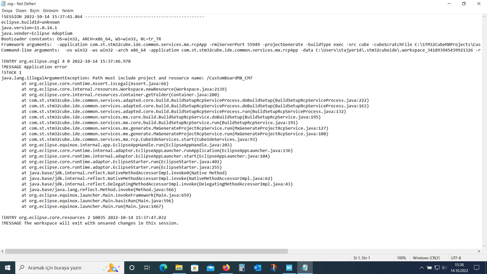

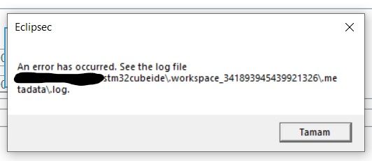

I tried to use STM32CubeMX but unfortunately I got an error. When I open the .log file, It says !MESSAGE Application error
!STACK 1
java.lang.IllegalArgumentException.

I think you tried to open your .project file (generated by STM32CubeIDE) in STM32CubeMX. This last one use an .ioc file instead.

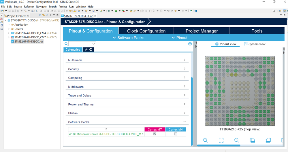

You can still use STM32CubeIDE and do the steps described in the video with this interface :

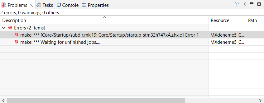

I didn't try to open my .project file in STM32CubeMX. I followed the instructions in the video. When I try to build the project, I got this error. When I check the Startup file, its name is startup_stm32h747xıhx.s . I guess that ı character might be the problem. I tried with some other MCUs with I character in their part name and got the same error. I also tried with STM23H750XBH6 because there is no I character in its part name. STM32CubeIDE builded the code successfully without error. I thought about changing the startup file's name but I don't know if it is safe. I don't want to break something. What are your suggestions?

I changed the startup file's name and it seems it worked. But that was an attempt without TouchGFX. Here is the latest situation:
If I try to start with STM32CubeMX, it throws that error with .log file. When I do not use TouchGFX generator, I don't face with this error. Also I tried to use TouchGFX Generator with STM32H750XB6 selected and it works. If I choose a MCU with I in its part name, it throws that .log error. I changed my computers language but it didn't solve the problem. I also tried on my colleague's laptop which is in English but nothing changed.

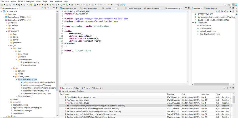

If I try to start with STM32CubeIDE, it throws "there is no such a file or directory" error for cmsis.h, freertos.h and also sometimes for app_touchgfx.h.
‎2022-10-31 1:12 AM
Okay, the problem is not part name, it is the dual core. When I choose a single core MCU, everything is ok. But if it is dual core, then I have issues.
