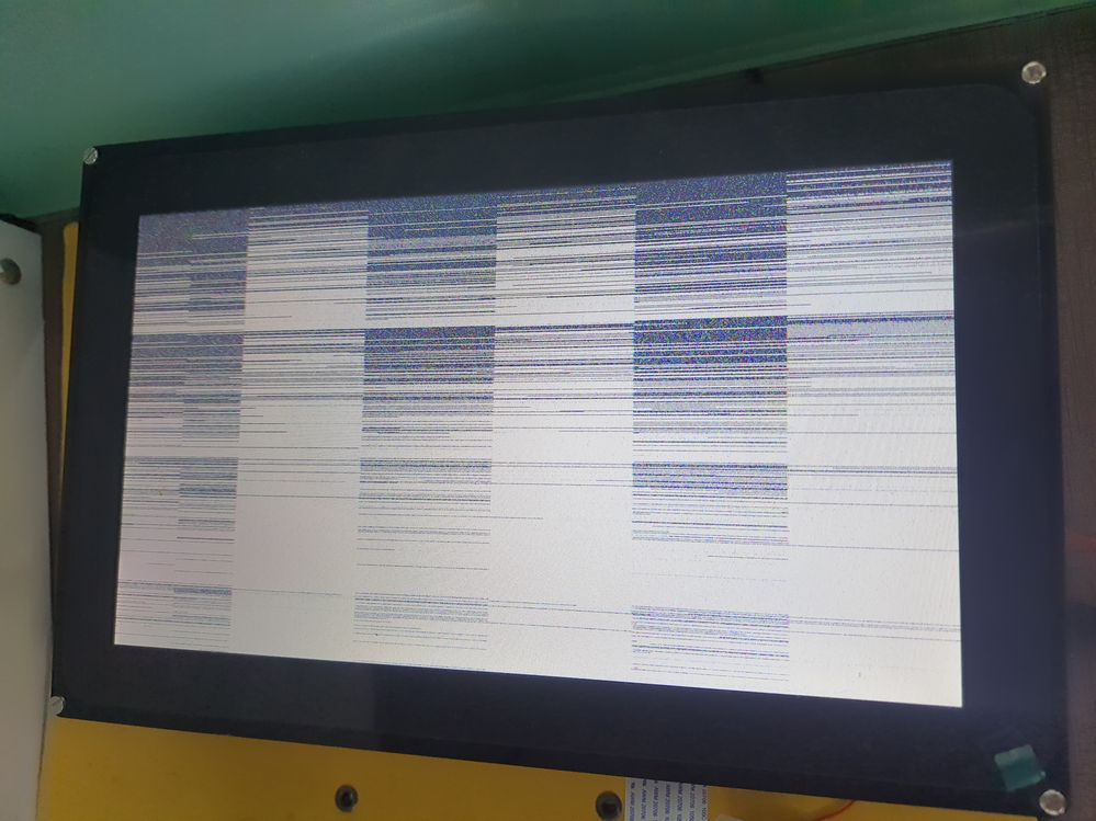

2023-06-08 2:41 AM - edited 2023-11-20 3:58 AM
@Jukka Pöppönen
I commented videoTaskfunction and now im getting flickering display...
2023-06-08 4:25 AM
Good :thumbs_up: for me it looks that LTDC parameters/polarities are wrong. What is the type of display ?

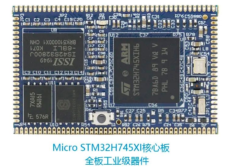

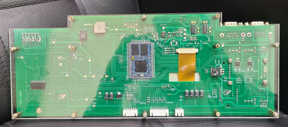

Hi ,,
Its not relevant to your question but ..
my recent development across STM32H745XIT6 Core Board and 1024X600 TFT running TouchGFX .
imran

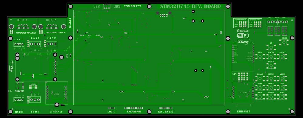

I am writing an article about LTDC & TouchGFX configuration.
Next week I will post in this forum .
My above custom designed board is with a lot of communications options.

Since TouchGFX need powerful controller so I developed the above board with dual core i-e stm32h745xit6 core board as under.
Since TouchGFX examples about my target core board was not available so I worked on BareMetal project for stm32h745xit6 and got TouchGFX running .
My plan is to run TouchGFX on CM7 & all communication protocols on CM4 with shared memory.

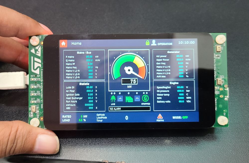

following is my test of touchgfx on stm32f469i-discovery with hex file attatched.
regards
