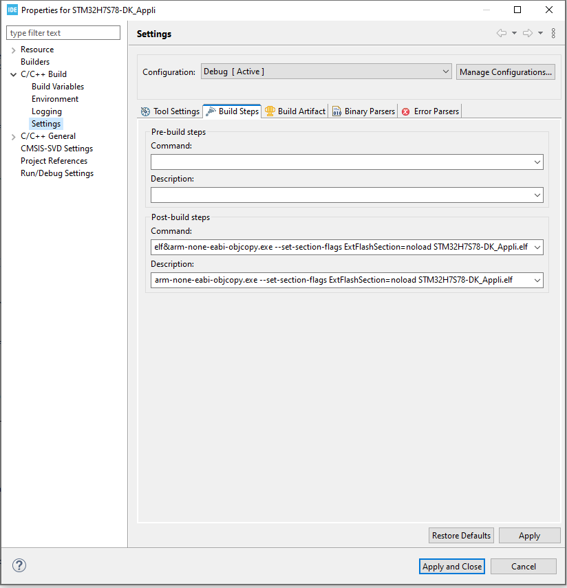

mathiasmarkussen
You can keep noload, but then you will have to edit the linker file and build twice to be able to extract your assets .bin.
What I meant is removing noload from the linker script, creating the .bin and then setting extflashsection to noload or removing it altogether using objcopy as I described earlier. You can automate this via post-build commands in CubeIDE:
2024-12-18 12_54_06-workspace_1.17.0 - STM32H7S78-DK_Appli_STM32H7S7L8HXH_RAMxspi1_ROMxspi2_app.ld -.png
The command I have set is:
arm-none-eabi-objcopy.exe --dump-section ExtFlashSection=images.bin STM32H7S78-DK_Appli.elf&arm-none-eabi-objcopy.exe --set-section-flags ExtFlashSection=noload STM32H7S78-DK_Appli.elf
 which should mark the section as noload after dumping the images. Again, I have not tried to flash a board, but the .bin is created for me.
You may also be able to use the normal debug and load profiles, since the file is modified as part of the build step.
