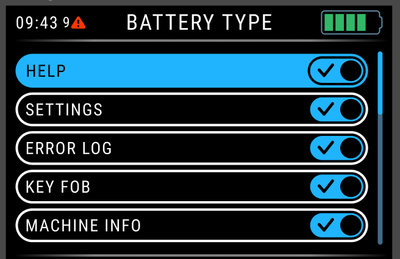

how to build the slider
miker
i need build a slider as following picture, when i change the item up and down , at the same time, the slider need move up and down with the item's movement;

As I see it, you have two options:
1. Use a Scrollable Container widget, which has a built-in scrollbar feature.
The downside of this approach is that you would need to implement item snapping manually, if you need that.
2. Implement a custom scrollbar using Boxes or Shapes.
This should actually be fairly simple, but you would need to implement the scrollbar movement logic yourself.
Which container type have you used for your current implementation?
