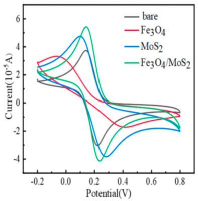

I use STM32U5A9J-DK to plot a graph containing a series of V-I data. I have tried static graph widget and was succeed, but it somewhere doesn't meet my need: the label can only show int, if  x data range is -0.6~0.6V, I can only scale them to -600~600, in mV unit, (but I want to show unit in V); besides, my data sequences may have the same x value with different y, e.g. (-0.6,2) (-0.2,5) (0,3) (-0.2,2) (-0.6,1), data like this can't be plotted on static graph, it only accepts monotonous x value.
I need my graph showing the original data points (need no scaling) and allowing same x value with different y values, Any other way I can build a graph fitting my requirement? I use touchgfx 4.26.1, seems no canvas function ?!
I mean like drawing the plot below, with a lots of on the same graph, and allow me to active/inactive the plot, each plot is a regression

OK, clear.
You are right - there is no built-in TouchGFX feature that allows you to do that.
My recommendation would be to create a custom widget using the VectorRenderer class. For simplicity, you could still use the graph widget to display the axes.

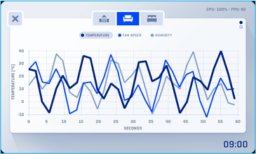

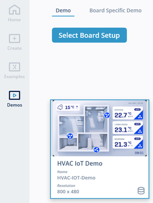

I am not sure I fully understand all the details of your request, but in general, I would recommend taking a look at the Graph screen in the HVAC Demo, which is available in TouchGFX Designer:
Here, three graphs are shown concurrently, with one of them highlighted. The labels are created using text areas to make them more flexible and versatile.

thanks, but what I need is to draw a regression data plot, like this, it increases, then decreases in X axis, seems static graph can't meet this requirement, because it only allows monotonous X axis, right?! I tried addDataPoint(), and it only plot the later data points if the x is repeat, e.g.these data (-0.6,2) (-0.2,5) (0,3) (-0.2,2) (-0.6,1),  on the graph will not plot (-0.6,2) , because it's replaced by (-0.2,2) automatically, seems I can only create a customized graph element to draw this data plot ....?
JohanAstrup
OK, clear.
