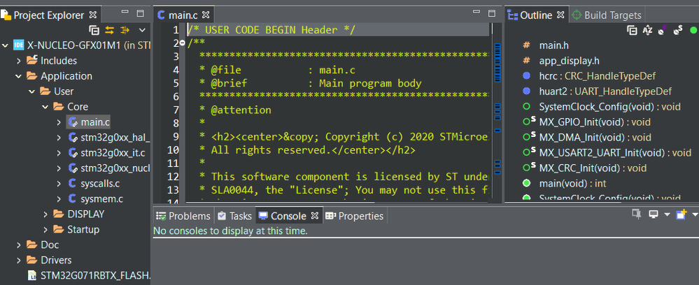

I dowloaded en.X-CUBE-DISPLAY_1_0_0 from ST site, but I'm not able to import the project into STM32Cube IDE.
If I go to "File -> import -> existing project into worksapce" the project is created into the workspace, but without source code.
What is the correct way to import an example project into the IDE ?

To use the Nucleo G0 with X-NUCLEO-GFX01M1, I highly recommend you to start with the Application Template available in TouchGFX Designer. In this project everything is already set for you to create your UI and see the result on the display. Just by clicking on "Run Target" in TouchGFX Designer you will be able to compile and download the project into your board.
If you want to use CubeIDE, simply open CubeIDE and then double click on the .project file. This will import the project in CubeIDE.

It is the correct way, maybe you selected something wrong while importing.
- File > Import > Existing Projects into Workspace
- Set root directory to the folder containing the extracted ZIP
- make sure the project X-NUCLEO-GFX01M1 is selected
- Finish
The source code is visible after opening the project X-NUCLEO-GFX01M1 (top left) and the following structure Application > User > Core, as can be seen in the image below:
