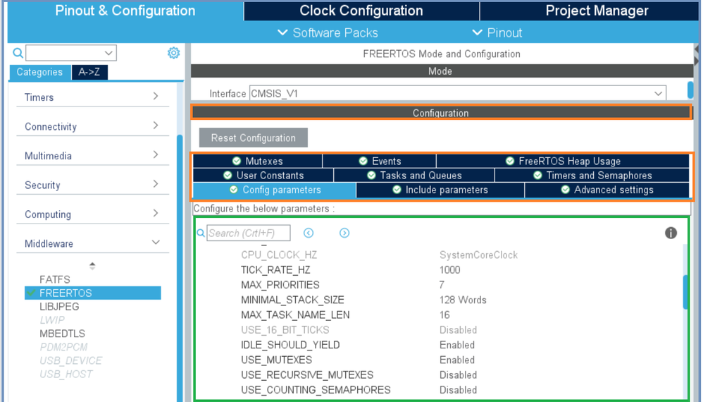

hello i am going to start graphic project on stm32 discovery board but altough my stm32cubemx is latest virsion but i dont have graphic icon in middleware of stm32cubemx can anyone help me thank you so mutch

It looks like you've already assigned a lot of pins that are needed to do graphics. But regardless of this, at least LTDC is necessary for graphics applications, which can be found under category Multimedia or under A->Z.
However, if you've never developed a graphics application on the DISCOVERY, you should start with TouchGFX.
