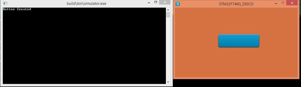

Indeed, you cannot access 3 callbacks of a button in general using Designer. For that, you need to implement it yourself.
I don't really understand the point of 3 callbacks when a button has only 2 states : pressed and released. Press and button down is not supposed to be the same ?
I tried a rough implementation of a button that triggers a callback in the screen view with the current state (PRESSED or RELEASED). For that I based myself on the Designer implementation of a Flex button, creating my own widget based on a combination of ImageButtonStyle.hpp, ClickButtonTrigger.hpp and AbstractContainer.hpp.
Here is the code of the widget as well as the screen view
customButtonContainer.hpp

You can try with this code first, but make sure the designer knows the bitmaps you're using for the button.
Just to be clear, it is only a rough example and not an official solution
Hope it will help
/Alexandre

0693W000006GovXQAS.jpgHi  Alexandre,
I am actually new to the TouchGFX environment. In my application, i need a button having both states (pressed and released.)
I have gone through the above posts and i've implemented the same in my application.
Able to create the button but functionality of pressed and released states are not working.
Below are code snippets:

Screen1View::Screen1View():buttonEventCallback(this, &Screen1View::handleButtonEvent)
	button2.setBitmaps(Bitmap(BITMAP_BLUE_BUTTONS_ROUND_EDGE_SMALL_ID),Bitmap(BITMAP_BLUE_BUTTONS_ROUND_EDGE_SMALL_PRESSED_ID));
    button2.setBitmapXY(0, 0);
    button2.setPosition(165, 100, 230, 60);
    add(button2);
	button2.setAction(buttonEventCallback);
	touchgfx_printf("Button Created\r\n");

void Screen1View::handleButtonEvent(const CustomButtonContainer& element, bool& buttonState)
    if(&element == &button2)
    	//HAL_GPIO_WritePin(LED1_GPIO_Port, LED1_Pin, GPIO_PIN_SET);
    	touchgfx_printf("Button Pressed\r\n");
    else
    	//HAL_GPIO_WritePin(LED1_GPIO_Port, LED1_Pin, GPIO_PIN_RESET);
    	touchgfx_printf("Button Released\r\n");
Could you please help me
Hello VPana.1,
Please refer to the enclosed project (working on 4.15)
/Alexandre
