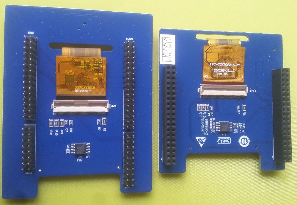

Hello - We are developing a TouchGFX project using a very similar display to that used on the X-NUCLEO-GFX01M2 AZ1 eval (board #MB1642). According to the ST BOM (attached), the LCD is Xinli PN TCXD022IBLON-5. Unfortunately, I can't find a datasheet anywhere online and I need it to figure out particular signals in our wiring. ST must have a copy of that document for internal development of the hardware and software on X-NUCLEO-GFX01M2 AZ1 (MB1642). Please help. Thank you.

Thanks for trying to help but the interface specifics in the schematics are insufficient. For example the schematic just shows 5 pins from the display going directly to 3.3V with no descriptions. I don't know which of those 5 pins represent power, control, etc and therefore can't leverage this design.

The screen is the DT022CTFT, it's marked on the cable assembly

  1. The screen is TCXD022IBLON-5, not DT022CTFT. Ref both the cable assembly printing and BOM for MB1642.
  2. The chipset for the screen is ST7789V, not ILI9341.
  3. I want to use a different display, but one also based on the ST7789V controller. The two displays should connect the same signals but I can't tell how to wire it into the eval board without knowing the functions of the individual pins.

The schematics do in fact have all the pins identified, by name, as the author dropped a symbol for what he/she was wiring against next to the header they were wiring too.
        TCXD022IBLON-5 XINLI FPC-TCXD022-5-V1 2.2" LCD INTERFACE ST7789V
 1  LED_K4 (BACKLIGHT CATHODE - 24.9R TO GND)
 2  IM0    INTERFACE MODE, LOW  (SPI - 4 LINE 8-BIT)
 3  IM1                    HIGH
 4  IM2                    HIGH
 5  IM3                    HIGH
 6  RESET  (*NOT* NRESET, PULLED LOW, 10K TO GND)
 7  HSYNC
 8  VSYNC
 9  DOTCLK
10  ENABLE
11  DB17
12  DB16
13  DB15
14  DB14
15  DB13
16  DB12
17  DB11
18  DB10
19  DB9
20  DB8
21  DB7
22  DB6
23  DB5
24  DB4
25  DB3
26  DB2
27  DB1
28  DB0
29  SDO    (MISO)
30  SDI    (MOSI)
31  RD
32  RS/SCL (SCK)
33  WR     (DCX) DATA/COMMAND
34  CS     (NCS) CHIP SELECT
35  FMARK  (TE)  FLY-BACK / TEARING EFFECT
36  VCC    (3.3V)
37  GND    (GND)
38  LED_A  (BACKLIGHT ANODE + TO 3.3V)
39  LED_K1 (BACKLIGHT CATHODE - 24.9R TO GND)
40  LED_K2
41  LED_K3
42  -NC-
43  TOUCH INTERRUPT
44  TOUCH I2C SCL
45  TOUCH I2C SDA
