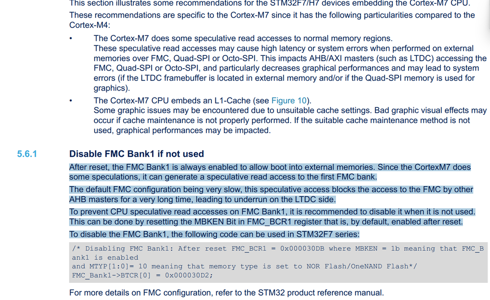

@CiuppaPT wrote:
Couldn’t this be the cause of our problem? Reference from AN4861.
The first MPU config, I provided to you (the background config) prevents that issue to occur. Moreover, the workaround of that limitation was already implemented in the system_stm32f7xx.c file / line 632:
   * Disable the FMC bank1 (enabled after reset).
   * This, prevents CPU speculation access on this bank which blocks the use of FMC during
   * 24us. During this time the others FMC master (such as LTDC) cannot use it!
  FMC_Bank1->BTCR[0] = 0x000030d2;
  (void)(tmp);
Now, as I said, try to reorganize your MPU config.

mƎALLEm
Did you set the MPU background configuration to prevent speculative access of CM7?
You can refer to this post.

You didn't confirm if you enabled the MPU background configuration:
void MPU_Config(void)
  MPU_Region_InitTypeDef MPU_InitStruct;
  /* Disable the MPU */
  HAL_MPU_Disable();
  /* Configure the MPU as Strongly ordered for not defined regions */
  MPU_InitStruct.Enable = MPU_REGION_ENABLE;
  MPU_InitStruct.BaseAddress = 0x00;
  MPU_InitStruct.Size = MPU_REGION_SIZE_4GB;
  MPU_InitStruct.AccessPermission = MPU_REGION_NO_ACCESS;
  MPU_InitStruct.IsBufferable = MPU_ACCESS_NOT_BUFFERABLE;
  MPU_InitStruct.IsCacheable = MPU_ACCESS_NOT_CACHEABLE;
  MPU_InitStruct.IsShareable = MPU_ACCESS_SHAREABLE;
  MPU_InitStruct.Number = MPU_REGION_NUMBER0;
  MPU_InitStruct.TypeExtField = MPU_TEX_LEVEL0;
  MPU_InitStruct.SubRegionDisable = 0x87;
  MPU_InitStruct.DisableExec = MPU_INSTRUCTION_ACCESS_DISABLE;
  HAL_MPU_ConfigRegion(&MPU_InitStruct);
  /* Enable the MPU */
  HAL_MPU_Enable(MPU_PRIVILEGED_DEFAULT);
No! This section is not in my MPU_config. I don't really understand its function. Should I include it ?
Yes, it's quite recommended in STM32 with CM7 core to prevent the speculative access. Even (maybe) it doesn't solve your issue, you should do it. It should be the first call in your MPU config, then you need to open region by region what you are using in your application: SDRAM, QSPI following their sizes.
Unfortunately, the MPU background init did not solve the issue.
