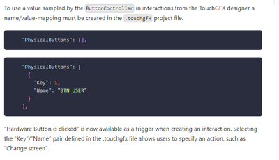

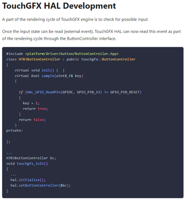

I am trying to follow this:
https://support.touchgfx.com/docs/development/scenarios/example-gpio
I am unsure where this code should be added:
I have modified this:
Everything compiles but whilst the LED toggles and the BTN_USER is selectable in the TouchGFX designer interactions drop down, the interaction doesn't get triggered. I am a bit stumped.

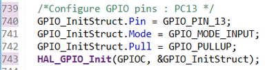

Sure, using CubeMX and CubeIDE
I have tried triggering it with an interrupt as well and again I toggle the LED but not trigger the interaction in TouchGFX. I just feel I am missing a step!
The GPIO setup

In CubeMX Try to set your PC13 to pull-up instead,

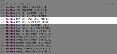

Here "HAL_GPIO_ReadPin" has "BTN_USER_GPIO_PORT" and "BTN_USER_PIN" in its function parameter.
These two variables are defined when you add label to your GPIO and generate the code in CubeMX, you can see their values in "main.h" :
If you use "GPIOC" and "GPIO_PIN_13" it also works, it's the same.
When you don't set labels in CubeMX, you can also check which "GPIOX" and which "GPIO_PIN_XX" in "main.c" :

2) Setup in your TouchGFXHAL file
Now open your "TouchGFXHAL.cpp" and add the following lines to each sections:
#include "MyButtonController.hpp"
/* USER CODE END Includes */
/* USER CODE BEGIN private variables */
MyButtonController bc;
/* USER CODE END private variables */
void TouchGFXHAL::initialize()
    /* USER CODE BEGIN initialize step 2 */
    setButtonController(&bc);
    /* USER CODE END initialize step 2 */

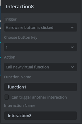

3) Setup in TouchGFX
To use your button in TouchGFX, create an interaction with a trigger "hardware button is clicked" trigger and select the key that you set for the button's GPIO in "MyButtonController".
If you modified your ".touchgfx" physical button section then, you will see your label displayed beside the key in "Choose button key".

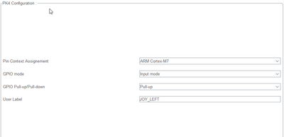

For your hardware button, can you try with another button ? Like "PK4" (Joystick left), configure it in CubeMX :
and change the "MyButtonController.cpp" with :
