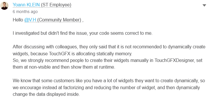

Hi @Community member​ ,
"I was creating TextAreas in runtime"
Could you share your technique of doing this please ?
Are allocating GFX widget on a Heap in e.g. in GFX::View constructor or GFX::View::setupScreen () and adding pointer to eg Container::add () ?
I am asking because I saw in few places that this is not recommended to do eg comment by @Yoann KLEIN​  here:
0693W00000aJ2jyQAC.pngI am not sure wherher to go new/delete path as implementation of GFX could change and cause application crash later in the project.
I work in Qt/emWin. Not being able to new/delete widgets is quite a change in a design paradigm/way of thinking - this is not a complaint, just a statement.
Thanks

It is really more comfortable to create controls in Designer and hide/show them as needed. But if you really-really eager such strange things, you can look in your ...ViewBase.cpp file and do more or less the same - new controls should be fields of your view. See also this discussion: https://community.st.com/s/question/0D53W00000ttGs7SAE/creating-textarea-programmatically-with-wildcard-and-buffer
