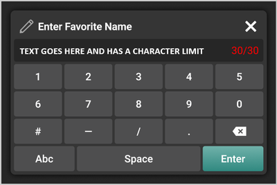

Hi again,
I'm looking to implement a character limit on a keyboard, as seen by the red 30/30 text in the screen below.

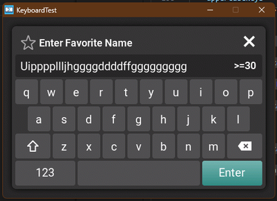

I call this function from `keyPressedHandler` and `backspacePressedHandler`, however I never see the text appear.
I tried adding some logic that conditionally determines which TypedText to display in the textArea, and that works fine.

I identified my mistake - even if you're ONLY setting dynamic text, you still need to create a TypedText with the contents `<>`
and set that TypedText for the text area...
    keyCountTextArea.setPosition(FIRST_ROW_X + 356, ZEROETH_ROW_Y, ENTER_MODE_WIDTH, KEY_HEIGHT);
    keyCountTextArea.setColor(Color::getColorFromRGB(0xFF, 0xFF, 0xFF));
    keyCountTextArea.setWidthHeight(KEYCOUNTTEXTAREA_SIZE * 12, KEY_HEIGHT);
    Unicode::snprintf(keyCountTextAreaBuffer, KEYCOUNTTEXTAREA_SIZE, "0/%d", BUFFER_SIZE - 1);
    keyCountTextArea.setWildcard(keyCountTextAreaBuffer);
    keyCountTextArea.setTypedText(TypedText(T_COUNTWILDCARD));
The rest of the code was left as-is, and it worked!
