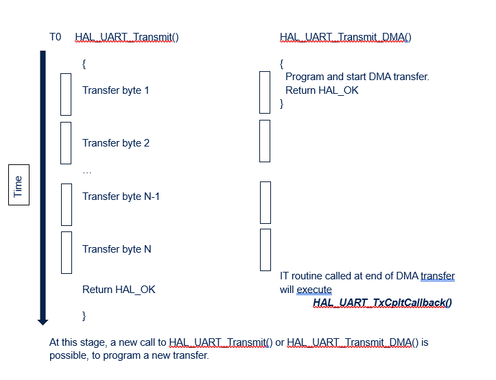

I have a feeling that DMA is way slower than polling. How can I see all through strings via DMA if I write the following in my main?
  HAL_UART_Transmit_DMA(&huart3, TX_String, sizeof(TX_String));
  HAL_UART_Transmit_DMA(&huart3, TX_String1, sizeof(TX_String1));
  HAL_UART_Transmit_DMA(&huart3, TX_String2, sizeof(TX_String2));
I notice that I only see the 3 strings if I add a small delay HAL_Delay(1) in between each HAL_UART_Transmit_DMA(). In debug, the DMA works fine, but in run mode, it does not.
Hi @Krautermann​
HAL_UART_Transmit_DMA() is a non blocking API : it means that when you exit the call of HAL_UART_Transmit_DMA(), transfer is not complete.
From what I understood from your answers, you need to wait for the execution of the TxComplete callback (end of the 1st transfer) before being able to call again the same API.
(this is also highlighted by the fact that inserting a delay is allowing to have correct result.
In your case, second and third call might be useless, as you will exit with HAL BUSY code (i.e. 1st transfer still ongoing).
To confirm this hypothesis, you could check the return code of each of your HAL_UART_Transmit_DMA() calls.
Regards
@Guenael Cadier​ I have tested it and HAL seems busy still after 1st transfer, how can i deal with this then? How can I make 1st transfer complete without using HAL_Delay?
I seem to be missing something and I don't know what it is.
Hi @Krautermann​
I briefly draw a chart to try to explain behavior differences between a blocking transmit API (HAL_UART_Transmit) and non blocking one (HAL_UART_Transmit_DMA). See below.
In case of DMA transfer, the end of transfer is notified thanks to HAL_UART_TxCpltCallback() callback execution. this callback is declared as weak in HAL (empty one), so you could implement your own callback in your code.
For instance setting a flag transmit_ok to TRUE in the callback, and waiting for it to be TRUE in your main could be a basic mechanism for synchronizing transfer end with further actions.
Please make sure to declare your sync variable as volatile, as it will be accessed from both main and IT routines, which could be problematic in some compiler optimizations configurations.
