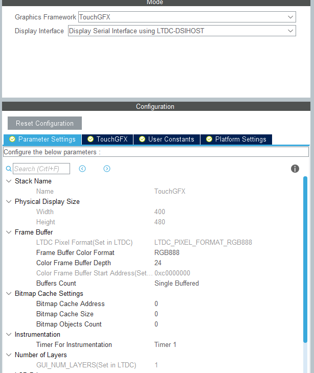

Look at the LCD configuration - the DSI interface uses the LCD settings for display size... Looks like you fixed it anyhow in code.
Yes, width in cubeMx is set to 400 but I can't change it because is inactive:
You need to go to Multimedia > LTDC. In the "Configuration" > "Parameter Settings", Change "Active Width" to 800.
That inactive 400 value will become 800 (At least in my case it is).
Ok, I set this but screen is enlarged because it change hltdc.Init.AccumulatedActiveW to 802, when I set this to 402 it's work.
