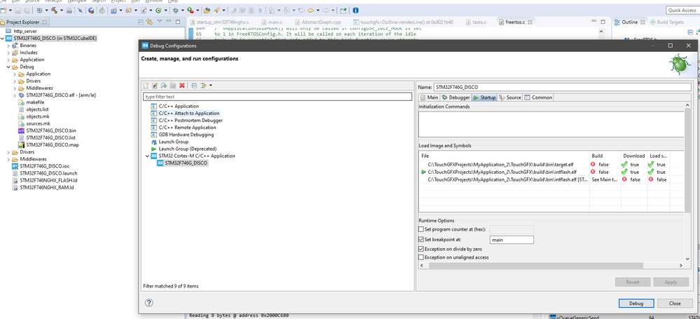

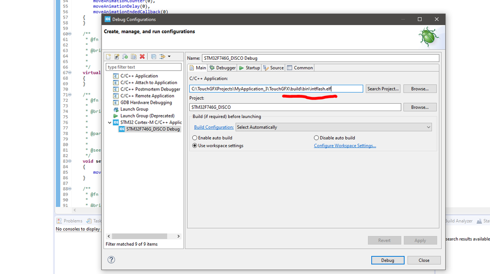

1) Click the 'Configure Debug' button.
2) Click on Embedded C/C++ Application in the left side pane. Then hit the + icon to add a Debug config.
3) Under the Main tab, select Search Project. Select Debug/touchgfx_demo2015_480x272_8MB.elf
4) Click on the Debugger tab. Be sure the SEGGER J-Link is selected as the probe.
5) Hit Debug - be patient as it can take up to 1m to download the external flash data for this project (over 3.5MB).
On subsequent debug sessions (as long as you don't change the image data), you can change the debug application to intflash.elf, which will not re-load the external flash data. This will be much faster.

1 REPLY 1
Vladislav Leschenk
I just have added target files without any "dancing with a tambourine".
The order files in first screen is important!!!
