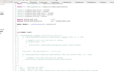

Second why do this in model tick. Model tick is executed on screen transitions and disrupt GUI if block.
Then go back to start AND SHOW CODE
Okay, For Eeprom operations will try without interrupt, hope that should solve the trouble.
Hello @MM..1 ,
The functions are in Model.cpp, not in the Tick function, I guess there is some confusion.

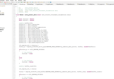

Some of the Data I am saving while device is turned off. but there are some scenario where I need to save some structure having 10-15 parameters to be saved into EEprom at run time, and Load those parameters also, hence need to go this way.  Just to avoid confusion here are the screen shots
Your showed screens is irelevant, show as code where you call this read and write ...
///code place as code no image

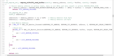

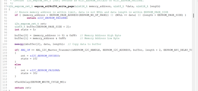

plus show source of  eeprom_st24c256 func...

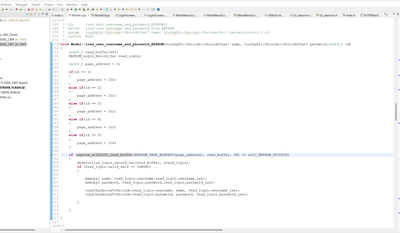

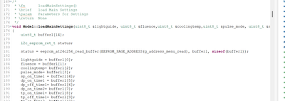

Okay, Here are the functions which are been call for Write Read operations
These operations are called from Model.cpp, eg void Model::loadMainSettings not from void Model::tick() function,
@Shiv09 you still not show where you call loadMainSettings !! And for I2C operation this type is optimal DMA .
Okay I am calling from the Screen Presenter, and this is called from Screen View, this is just one of the examples which I am using for read /Write operation.
View-> Presenter-> Model,
